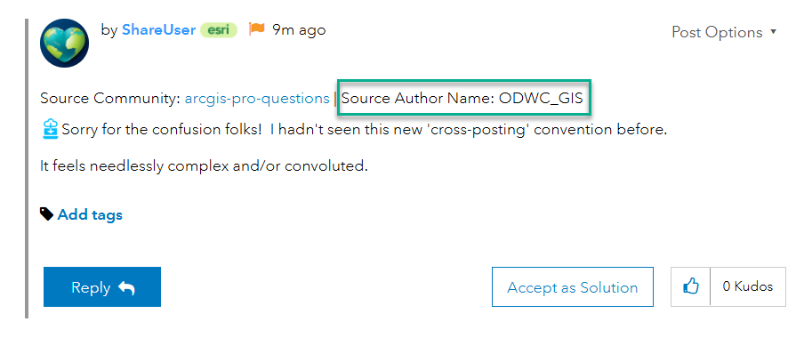

ODWC_GIS
This is the second strangest change AGOL has implemented in the last 3 months.  I see that in the Original Posting Location Thread, you and I (who are interacting with the thread in the GIS Life Board) are listed as @ShareUser
Won't replies to Participants get horribly mangled?
ShareUser
Esri Community Manager
Sorry for the confusion folks!  I hadn't seen this new 'cross-posting' convention before.
It feels needlessly complex and/or convoluted.
JesseCloutier
Hi all, the way the Share Tool works requires that a shared account be the source that manages copies of posts and comments. To help clear up confusion and aid everyone in recognizing differences between different users, you can still see the original author of a post or comment shown near the username. We recognize there is room for improvement with the feature, but I hope this helps!
