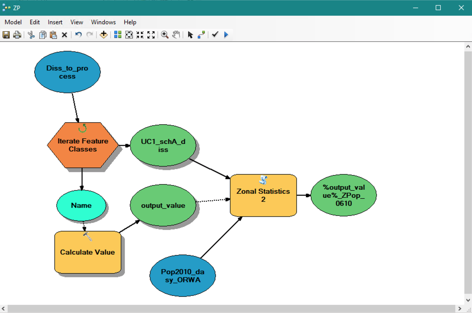

Note that the ZS2 is running in this model, just a simple iterator, although in this case there is only one feature class ("UC2_muni_A_diss") while I am troubleshooting. The feature zone polygons are collected in a feature dataset ("Diss_to_process") in a .gdb. The raster is in the same .gdb, a FGDBR file with 30m cell size, 32 bit floating point pixels.
