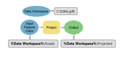

I would suggest reading up on the following: Inline variable substitution—ArcGIS Pro | Documentation
I'm a bit rusty but believe that you should be able to create a parameter from their input value (year) and add this value to the end of the output name. Something like SurveyResults%Year%
GabrielScarcella
Take a look at the following article: Export layers with a current date in the output layer name in ModelBuilder
With a slight modification to the proposed expression, you should achieve what you need.
