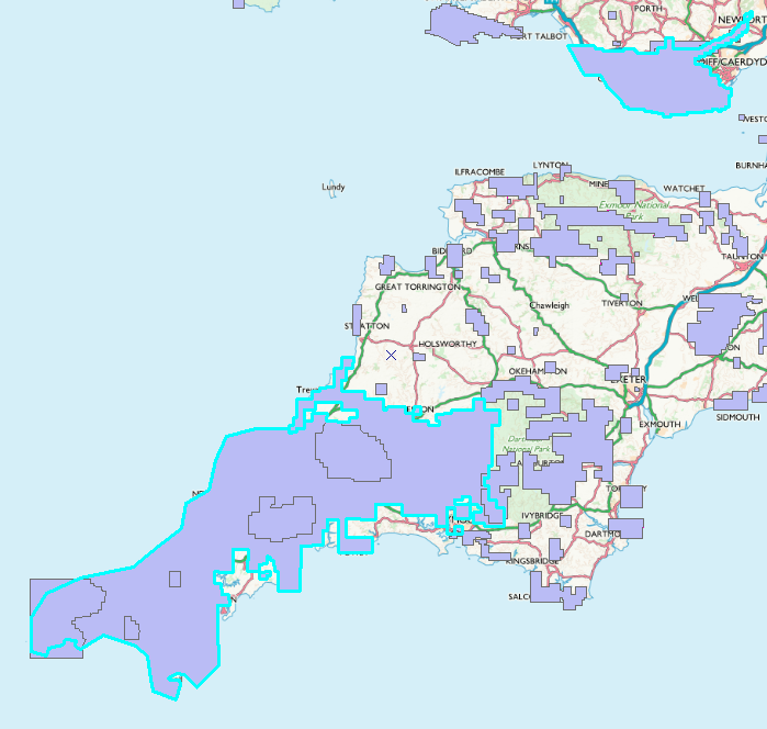

Hi I have polygons in one layer covering parts of the UK. I'm trying to merge them into one single shape (so I can use it to clip other features), but a small number of the polygons appear corrupt...
For example, I want to merge these two shapes (highlighted):
Editor>merge:

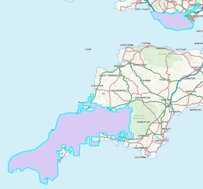

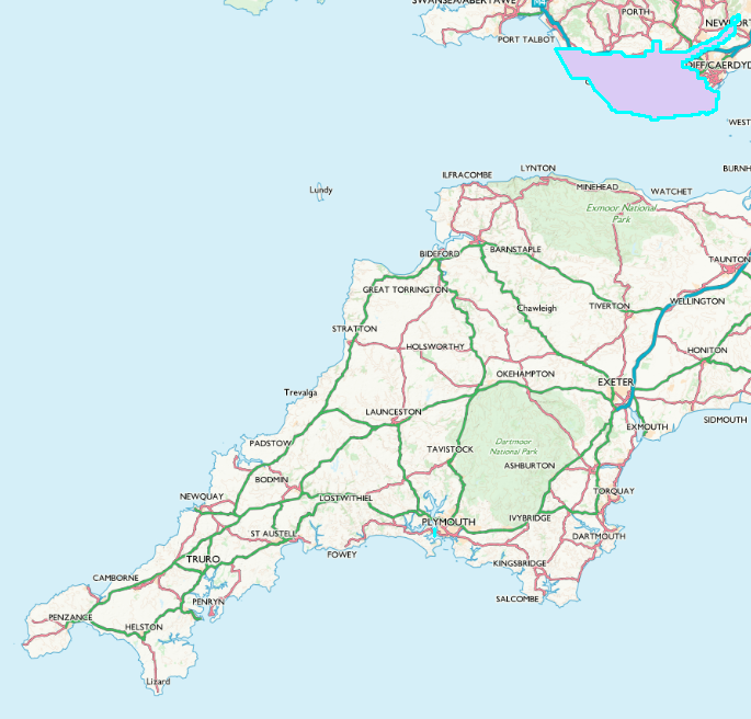

The shape in the SW deletes after the merge function is used.
Does anyone have any idea what's happening?

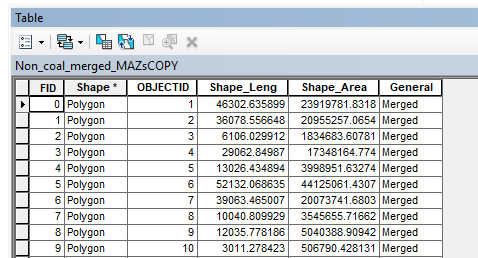

5. The current attribute table-
'General' is a text string field FYI. The other fields are auto-generated.

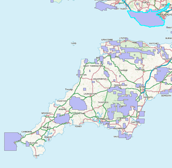

6. Even if I select the two shapes used earlier and export them as a new shapefile...
Merging them still has the same result (no matter which of the shapes I choose to merge into):
I'm puzzled that this apparent corruption has carried on over to brand new exported shapefiles (and FCs, CAD files too!)

On closer inspection, could this merging issue be due to poor geometry?
The shape twists on itself here.
