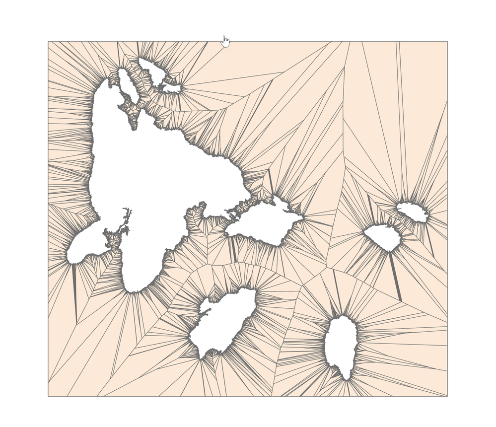

example for some islands in Nunavut Canada, lambert conformal conic projection.
Select by location with have their center in to remove the voronoi polygons that were within the island polygons.
next steps perhaps convert voronoi to polylines
polylines to segments
select segments that have an endpoint touching an island
remove them and that should leave the remaining lines
... sort of retired...

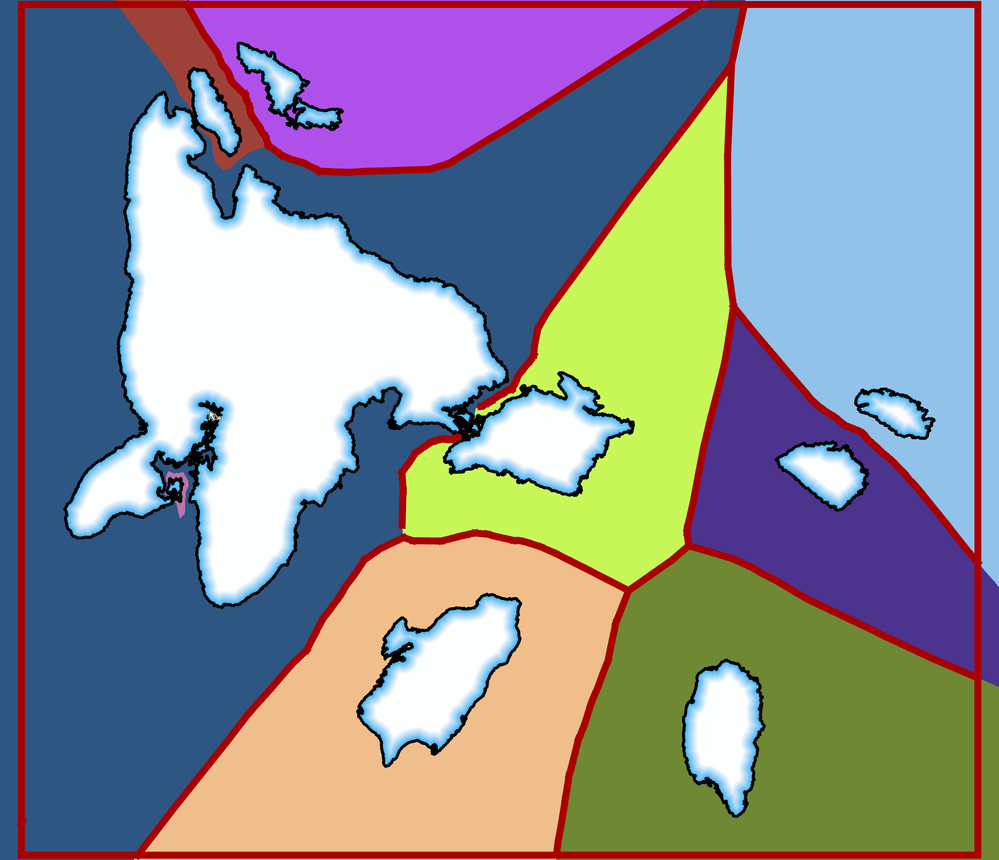

DanPatterson
MVP Esteemed Contributor
Both work,  the voronoi approach (around my islands) does allow you to devolve the voronoi edges incrementally if you want to explore other things.
In the image below is the eucl-alloc raster and the devolved voronoi.  The latter was produced by first using select by attributes any polygons that abutted the island.  The remaining polygons were converted to polylines, then I used trim lines to remove dangling lines (lines with only one touching end point.  I didn't specify a dangle length just so I could monitor what was happening.   There are other ways of processing the data, so don't take this as the procedure to follow in all instances.
