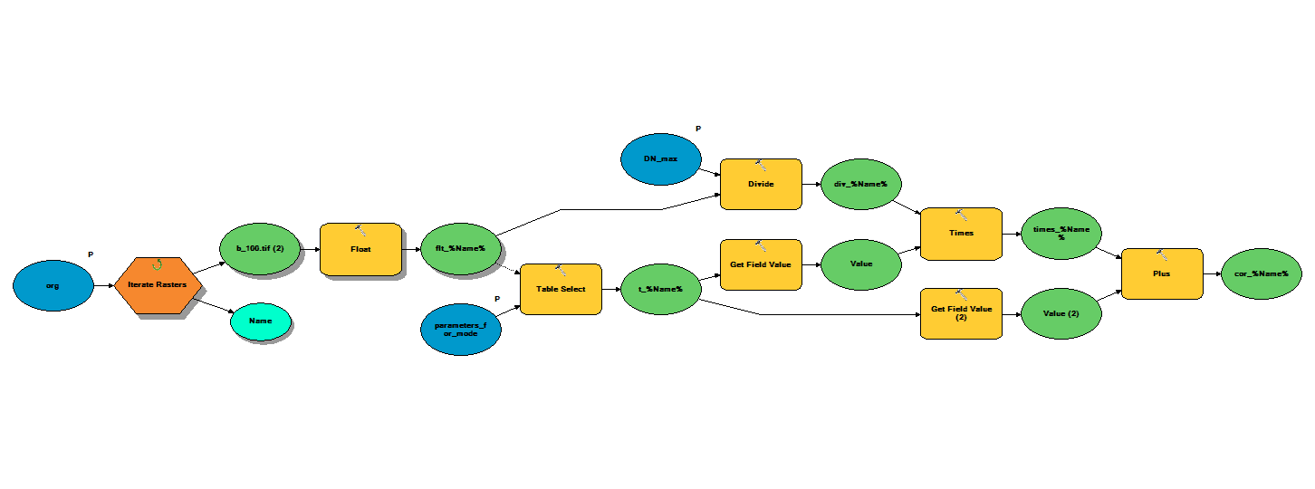

Hallo,
I'm trying to create a model that uses values from a single table, in order to perform a different calculation for each raster in a file.
Each raster is represented in the table by a row that contains the raster unique name (string), and 2 other fields with the numeric values for the calculation (slope & intercept).
I use "Iterate rasters" to go through the files, and "Table Select" where I select the relevant row for the parameters, by using %Name% (from the iterator) = name (the raster name in the table).
Doesn't work... the model gets stuck in the "Table Select" stage.
Does anyone have any idea why?
I attached python code and image of the model.linear_correction_parameter_from_table_img.png
Thank you!

Okay try this:
Add a Calculate Value​ tool in to calculate a valid name for the output table the code would be
"%Name%".split(".")[0]
Then change the output table name to t_%TableName%
15 Replies

It would probably be best if you upload the actual model builder tool and not a python export of the tool. Thanks.

Okay, I added
Thank you
LukeSturtevant
Is your table that you are selecting from in a local geodatabase or file system?
Have you tried putting single quotes around the %Name% in the selection expression?

yes,
doesn't seem to help.
The model also added in tbx

the table is from a local geodatabase
LukeSturtevant
Then maybe try taking the double quotes off the field name:
name = '%Name%'

Did not work, sorry ...
LukeSturtevant
Could you post a sample of your data? Maybe a raster and the table you are working with? Also could you post a screen shot of the error your are getting?

Sure, attached.
If I run the model in edit mode, when the model is open, it reaches the tool "Table select" and simply stops ("finished").
In the results panel I get:
<Cannot create output <value: 000210
