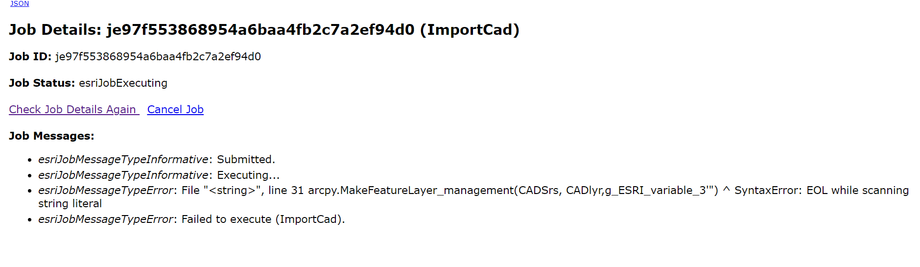

Hi guys,
I am new to python , I am trying to read some data from CAD file using the below script , the script is works fine on Arcgis Pro 2.9.1 with no Errors But after publishing this to Arcgis server(10.9.1) as Geo-processing service and Submitting a job (post)  the job fails and showing me the following :
  • esriJobMessageTypeError: File "<string>", line 31 arcpy.MakeFeatureLayer_management(CADSrs, CADlyr,g_ESRI_variable_3'") ^ SyntaxError: EOL while scanning string literal
  • esriJobMessageTypeError: Failed to execute (ImportCad).
