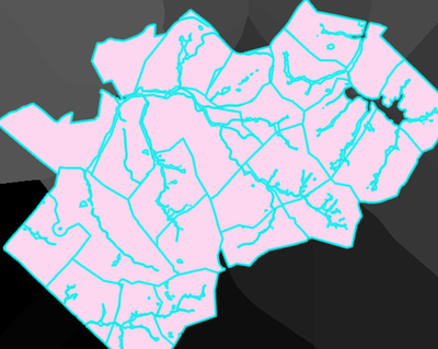

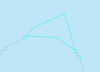

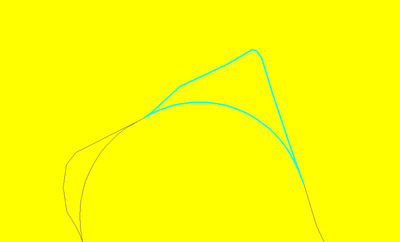

Hello. I'm trying to split small polygons and merge them into the nearest _large polygons. With the Eliminate tool, the small polygons are merged into the large polygons but the boundaries between the two polygons look strange. Is there a way to do this automatically anyway? The feature class has thousands of small polygons that cannot be done manually.
After using Eliminate tool:

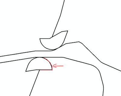

Actually I am trying to split small polygons automatically .  check the below pic. I want to split the small polygon based on the red line and merge the two created polygons to the closet polygon. is there any way to created the red line automatically?  or in another way, can we split the small polygon based on the intersection with the other two polygons and merge into them?

The small polygons and large polygons share just a border. If I separate the small ones and use the intersect tool, how I can get polygons as the geometry type in the result? if I choose the geometry type("input" which is polygon) the result is an empty shapfile. Also, I cannot draw a line to separate small polygons and then split them based on lined as I have thousands of the small polygons. The red line in the below picture is showing the shared border between the large and the small polygon.

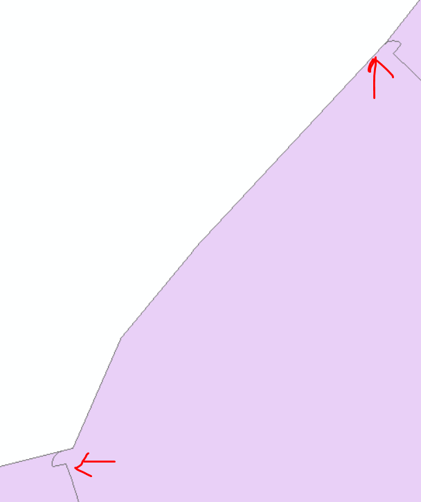

This solution works perfectly for me, after converting raster to polygon I needed to use clip, cause Euclidean Allocation extended the boundary of the outer polygons.
Also, in converting polygon to raster I lost the other fields of the attribute table, I used the join to have all fields after converting raster to polygon and also I used dissolve tool to join the polygons with the same ObjectID.
But there is a slight issue with my final feature class. Please check the picture below.
How can I get rid of the little cells?

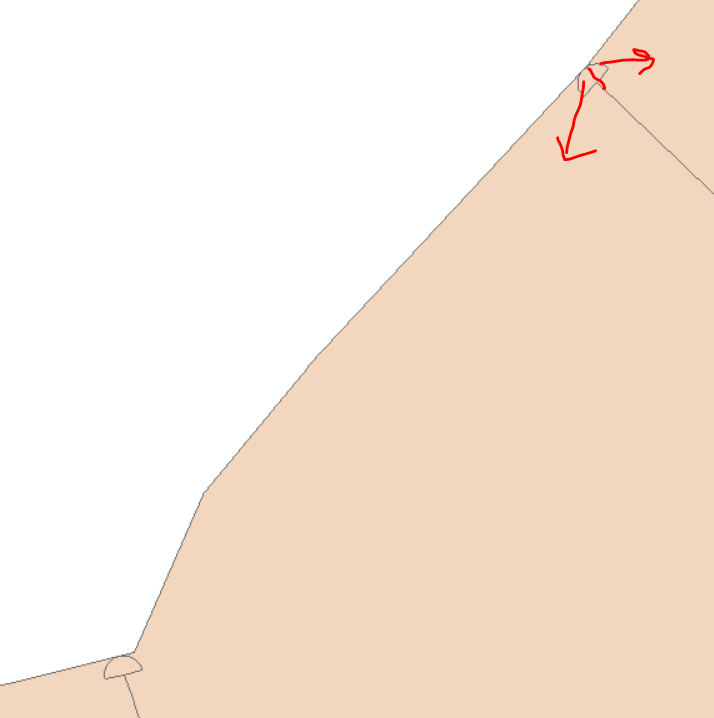

the polygon in the base feature class:
I think it's good to mention that I tried different cell sizes in the second step and I got the best with 0.5 m.

sounds like we're making progress. You can prevent the EucAlloc tool from spreading where it shouldn't by creating a background polygon that covers your analysis extent. One way to do that is to add a 'priority' field to your polygon feature class, create a rectangular background polygon, and give it a lower priority than the features you want to keep. For this to work, you'll also need to give your sliver polygons some id that you can use after rasterizing to turn the sliver cells into NODATA.
As an alternative, if you have the production mapping extension, you can create a 'difference polygon' in the editor, which will avoid creating any overlaps with the existing polygons.
For the raster to polygon step, did you specify 'SIMPLIFY' for the simplify option? Also, you can enable the 'create multipart features' option to do the dissolve as part of the conversion.
It may not be possible to remove all of the jaggies from this process. If you still have problems with the output, send me some anonymized input sample data and I'll see what I can do.
