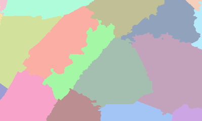

3. execute polygon to raster gp tool, using an attribute that uniquely identifies each non-road polygon as the 'value_field' parameter. We'll call this output raster "PolyR". Here's an example of what "PolyR" might look like (the white is nodata):

6. In ErasedRoadsR, the cell values from PolyR have been 'spread' to the nearest NODATA cells.

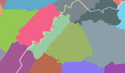

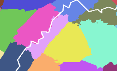

Here are "PolyR" and "EraseRoadsR" shown together, using transparency for the latter. in EraseRoadsR each NODATA cell from POlyR is assigned the value of its closest DATA neighbor, thus 'filling in' the NODATA gaps.
 7. Finally, you can use the RasterToPolygon GP tool to convert back to a polygon feature class. You can use the 'Simply' parameter to get rid of the jaggies.
