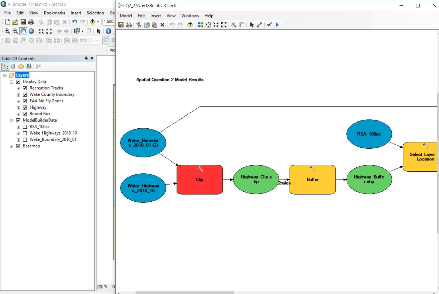

I have the regular set up of a model inside a toolbox within a .gdb. I've built several models but only had to turn in for school a toolbox once. I checked my parameters in the old model against the new one and it seems to be the same. By that i mean no parameters or variables needed. All the model has to do is run in the teachers computer.
As of right now, the only way for the model to work is if the teacher stops at the first output and changes the location, which then in turn changes the input for the rest of the model. All data used in the model is original data that is within the accompanying mappacket. Included is a pic of the first break.

So everything worked after several different experiments. Adding all model initial inputs from the TOC, and the toolbox is stored in a folder (not .gdb) and saved to a folder or %WORKSPACE% extent in geoprocessing resulted in a successful run on another computer. Here is a picture of my tests, it may not make alot of sense with my crazy file names but their just for my tracking purposes.
