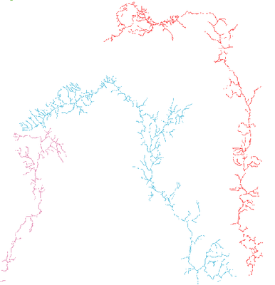

Here is the attribute table from the combined rasters - each number under "RoadCORINE" represents a unique land use type, while each number under "RasterRiver_CopyRaster1" is a unique river. The output looks like below, where only rivers show (they should be surrounded by other land use types).
Hopefully this helps.

what were the values surrounding the rivers?  If they had a value other than nodata, you have to adjust for it in the con statement.  Landcover isn't going to show through unless it is nodata on top
In pseudo code
Con("river", "river", "landcover")  meaning if the river is data, then use river, if there is no data, then use landcover.
but if the area surround your rivers has a value of '0' and '0' isn't nodata, then all you will see is what was in the river layer.  (in which case you could just add the layers together and the land would shine through, but your rivers would have a different class value)
