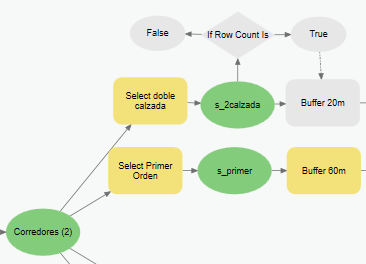

I'm trying to select from a dataset from a feature class. Then I would like to know if there are any records to make a buffer. I'm trying to do that using "If Row Count Is" tool, but I think I'm not understanding because the next tools has became in gray.

Thank you for your interest. Yes, I need to know if the feature class called "s_2calzada" has any records because the previous select tool might get zero records. If there are records it must continue with the buffer tool.

How do the parameters look in "If Row Count is" tool?

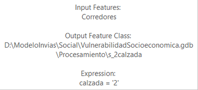

What tool is "Select Doble Calzada"? How do the parameters look in that tool?

It's a Select tool "Select Doble Calzada" and its parameters are:

It doesn't work either 😕  The get count tool derives an integer, in this case is zero, but the "If Row Count Is" tool is expecting a "table view", it takes the row count value as a condition.RicardoSanabria1_1-1640225309313.png
