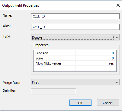

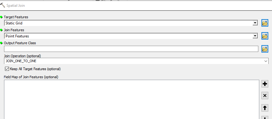

Hi all,
I only want to my output to have two fields.
I press the add/plus button in the Spatial Join tool, then type in properties of Output Field (see screenshot) and press OK.
But there is nothing saved:
I have also tried to make a variable from Field Map of Join Features, however same thing happens - i can type it in, but nothing is saved.
Any ideas?
Thanks

Aren't the fields getting automatically updated in "Field Map..." when you fill the Target/Join/Output Features parameters? You could just delete the fields (that you don't need) from the list.
Think Location
erinheinrich
No - I'm creating a generic tool with parameter inputs, but I know that one of the inputs will always have field "CELL_ID"
DanPatterson_Retired
MVP Emeritus
try specifying the save file and location first, perhaps an output verification is required before the mapping
erinheinrich
as above, can't do that, that is the idea of the tool...
curtvprice
MVP Alum
I think Dan may be right that the output has to be specified. This is because the output field naming can be workspace type specific, for example, shapefiles are limited to 10-char fields and gdb's are not.
In my experience if the input is coming in as a model parameter, the only sure-fire way of getting the exact field map you want is to use Calculate Value to run a Python function to create a field map. The arcpy field mapping code is tricky until you get good at it.
Another much simpler workflow to consider for dropping fields is to create an empty feature class using the feature type and coordinate system of the input, add only the fields you want, and run Append with NO_TEST.
erinheinrich
Thanks Curtis,
Yes, looks like python might be the only option, doesn't seem possible in ModelBuilder.
Unfortunately i'm terrible at python, so I might just have to deal with all the fields for the moment!
