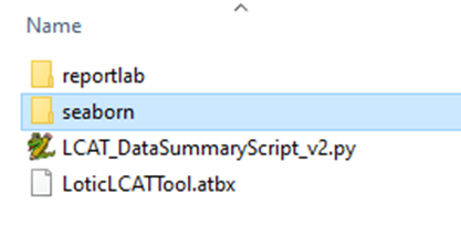

I am using the trick to have any Python packages I need sitting next to the script and then using one of these
sys.path.append(__file__)  - way I use
sys.path.append(sys.path[0])  - way i see this in the help
This gets around the issue where users need the packages installed.  This all works great in a toolbox on the file system.
But when I go to publish this as a GP Tool ArcPro is scanning ALL the .py files down in the package directories.  This can take hours!  Plus then it throws all kinds of crazy errors.
Is there anyway I can stop it from doing this?  I tried reference data and copy all data but it still does the big scan.  The scanning and path changing it does has always been highly annoying and problematic but this is an all new level.

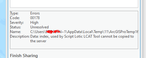

I am also getting this weird message about some Index directory?  It is there but nothing in it.  No matter what I set the environments to it still goes to My Documents and makes this dir with nothing in it.  No idea why it needs it or how to fix.  New issue in Pro 3.1?  Tried deleting it but it just comes back.  There are 0 paths in my script to anything.
thanks
