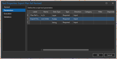

Hi everyone,
I'm trying to piece this process together, but can anyone point me in the direction on how to publish a python script tool to ArcGIS Server as a geoprocessing service for the purpose of using it within the geoprocessing widget in ArcGIS Web App Builder?  The script tool runs successfully within Pro, but ideally I would like to use it within an existing Web App Builder application. The script tool uses an input polygon layer, which has a URL link to a pdf document for each polygon record.  Within ArcGIS Pro and after selecting polygons, the tool will output the pdf documents to a specified output folder (technically an input parameter).  Assuming that this tool can be published as a geoprocessing service, how would the user select polygons within the web app builder application or geoprocessing widget?  Below is the python code for the for the tool as well as a snip of the tool in ArcGIS Pro and a list of its parameters.  Any help or guidance on this subject would be greatly appreciated!

mody_buchbinder
Hi
You need to publish the tool to the server to make it gp service.
You have some issue with such a script as a service.
Does the server (and the user that runs it) have access to the fc and dest_path?
Using gp services need some thinking about access rights and multiple requests from different users
