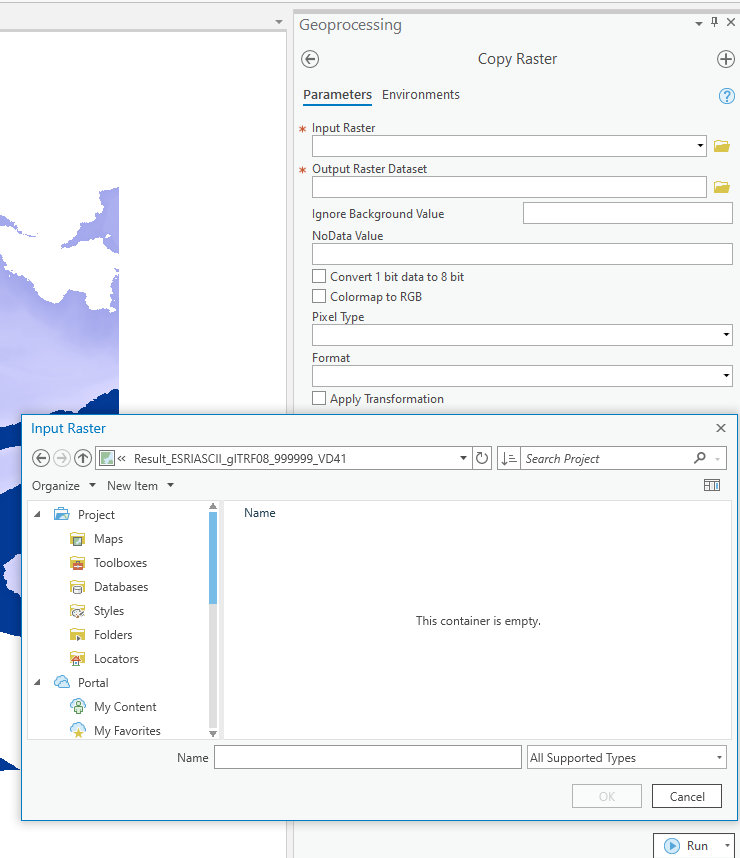

Today, using Pro 2.6.0, I used the Contour List tool to directly extract a contour line from an ESRI ASCII file (e.g., file1.asc).  For Input Raster I was able to select file1.asc by browsing to the file. It ran successfully.
I tried to run Contour List again, selecting file2.asc for the Input Raster, however, the file does not show up when browsing to it from the tool.  I can browse to and see the .asc files in Catalog, but cannot load them into a map window (the solution that worked for people in the above link) and they no longer show up when browsing to them in the tool.
Next, I tried to use Copy Raster to covert the .asc to a .tif first, then run Contour List. However the Copy Raster tool will not show .asc files either:
The ArcGIS Pro Copy Raster help here does not show .asc as a file option, but numerous other pages and help discussions say that 'Copy Raster' is the way to convert from ASCII to Raster now that the 'ASCII to Raster' conversion tool has been retired.
Next, I installed the Pro update to 2.6.1 and restarted the computer. Same result.
How can I get Pro to recognize the .asc files so I can convert them to a tif? Or use them in the Contour List tool directly? Note, I did see here that says you cannot use ASCII files in the Contour List tool directly, but it did work the first time I tried it and i have the geoprocessing history and resulting vector contour to prove it!  This is very perplexing!

FrancesBiles1
Hi Dan,
Thank you for your suggestions. I had already tried all the possible selections under the file type dropdown to no avail. It doesn't matter what I select, the result is the same:

FrancesBiles1
This time, when I selected file type = Files, the .asc showed up for the Copy Raster tool (I tried this before, why it works now who knows, probably operator error):
However the .asc files still don't show up for Input Raster in the Contour List tool.  It is so weird that it worked the first time I tried, now nothing. The file type in the pulldown by the red arrow only offers this one choice.
The .asc files are visible in Catalog and Windows Explorer.

FrancesBiles1
I've refreshed the folders a million times. Tried again on both the C-drive folder and external drive. No luck.
