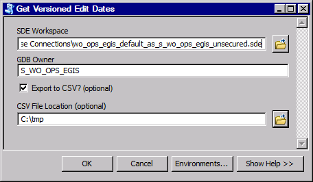

I wrote the following geoprocessing script tool In Python for the user to use with ArcToolbox:
GUI
GUI VALIDATOR CODE

STANDALONE PYTHON SCRIPT

Hope this helps you.
Sincerely,
John P. Lovato
USDA Forest Service
Geospatial Database Engineer
