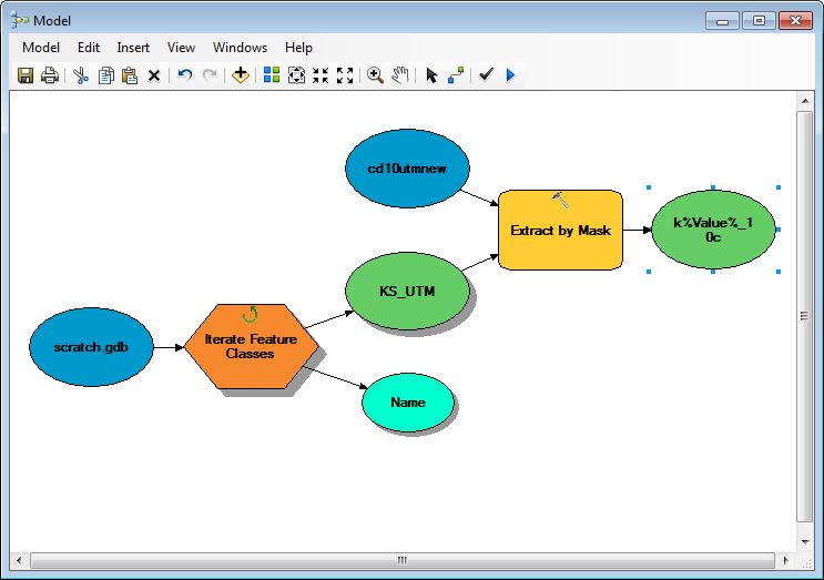

I am trying to use Model Builder with Extract with Mask. The masks (polygons) are in a file database and the raster is a standalone GRID. When I run the model it exits with an error that is the Table name is invalid. I tried to investigate the meaning and I came across two explanations. One: don't start names with digits. Two: names can't be longer than 13 characters. I think I've met those restrictions, but I still get the error. I think I also read somewhere that you should save to a database, but I swear I've done something similar to this months back and saved in a folder without problem. I'm out of ideas at this point. model.jpg

As far as I can tell, there is no such variable as %Value%, but there is %Name%.

path can't contain spaces or other unsavory characters (except _ ) and the total path plus filename must be less than 125ish characters.  Also, if you dont specify a file extension, you will get an esri grid which is fine.

Xander, the projections match for the masks and the raster. I did not change the extent, so it'd be whatever the default is...  I think a reply after yours hit the nail with pointing out that I had used "%Value%", instead of "%Name%", so you were on to something. Thanks for the help!

Darren is on to something...I suspect Value was supposed to be a field in the raster table, which hasn't been set as a variable

DINGDINGDINGDING... the winner! You were right, Darren, I referred to a non-existent variable. Thanks a lot for the help!
