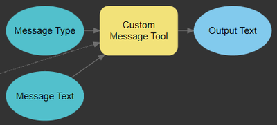

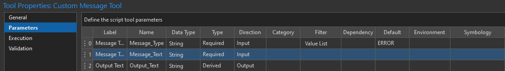

Handy tool! I've just customised to make a simpler version for my own use. Others may find handy.
# GP Script tool - Message
# for use in ModelBuilder
import arcpy
# Two text parameters:
# 0) Message type: ERROR, WARNING, INFORMATIVE
# 1) Message text
msgType = arcpy.GetParameterAsText(0).upper()
msgText = arcpy.GetParameterAsText(1)
# Return msgText and format based on msgType parameter
if msgType.upper() == "ERROR":
  arcpy.AddError(msgText)
elif msgType.upper() == "WARNING":
    arcpy.AddWarning(msgText)
else:
    arcpy.AddMessage(msgText)

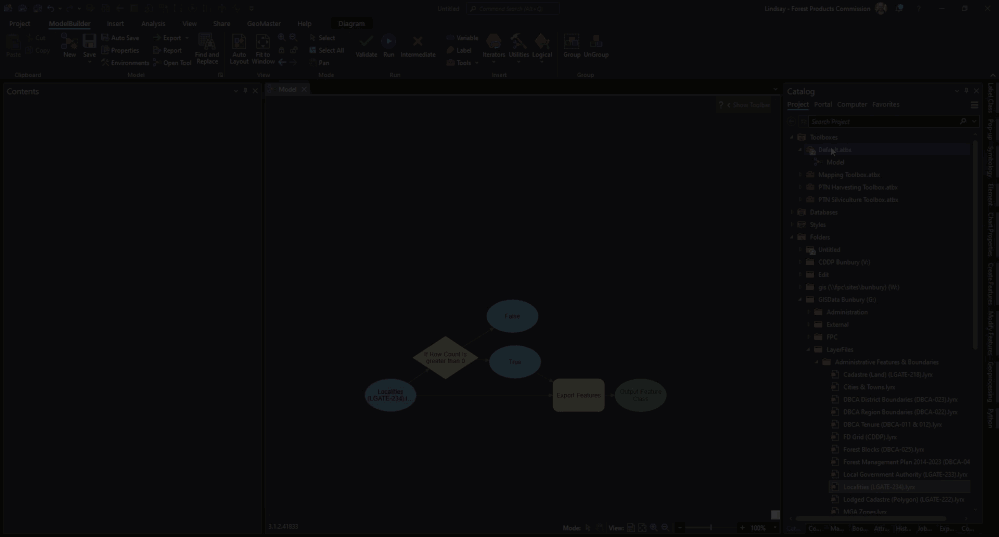

The below GIF runs you through the tool creation and use, but if you would prefer to see it in full resolution and without so much cutting, watch it here on YouTube. The code used in the video is posted below. Even better - sample toolbox attached!
import arcpy
# 1) Message text
else:
