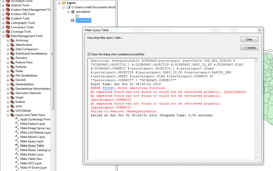

CharalambosMattheou4
I have the same problem here. Data are stored in the same workspase. Any advice? Is there a step by step tutorial with relevant dataset available?
Thanks
Charalambos
Solved . " " in sql statement was the problem.
regards
Charalambos
RichardTruong
Yulp, remove the " " in the sql statement will resolve the issue.   Thank you.
