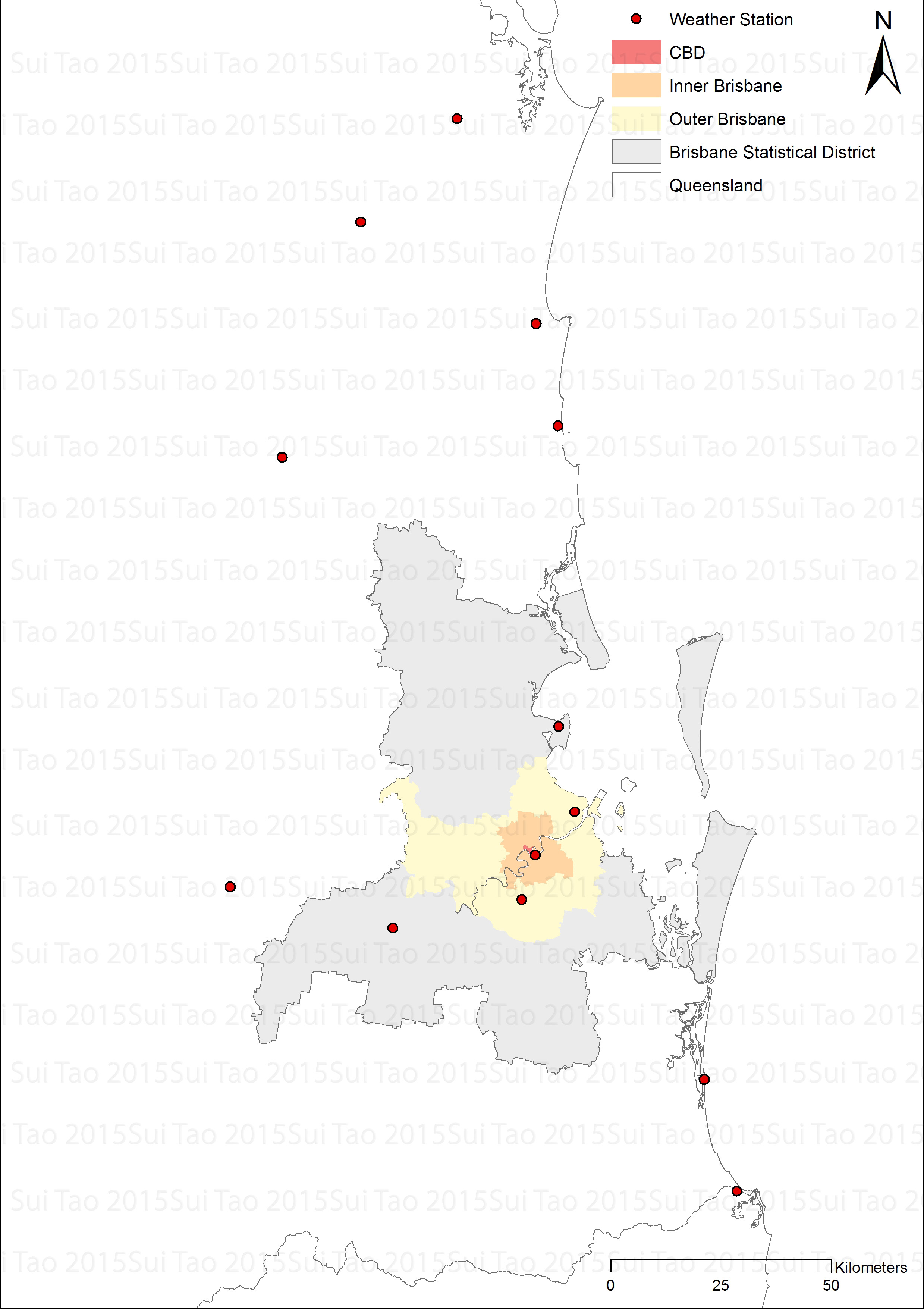

Hello Everyone,
I'm trying to use spatial-based weather data (temperature, rainfall, wind, etc) to estimate and create a weather surface across Brisbane, Australia. I only have data of 13 locations in total as shown in the attached figure across Queensland, the state for which Brisbane is the capital city. It seems that kriging is a possible and proper solution to fulfill my goal. However, some suggested that at least 30 distinct locations of data were ideal to do kriging. I currently don't have other datasets and doubt there will be. So my question is how can I apply the kriging method to this rather sparse weather data to generate a reasonably acceptable results of weather surface? Do I add artificial points such as copying the same data point to nearby locations?
Any suggestions are welcome. And thank you in advance!

larryzhang
sui,
The weather data are already via 'maximizing spatial independence among sample locations' over Greater Brisbane landsacape.  Advisable to always keep in mind that sampling data (locations) are reliable, not from artificial works.
Regardsing Krigging interpolation that you intend to use onto this set of data, generally, you can do so.
On Greater Brisbane landsacape, however, it is reasonable to use other methods as well.
Personally, those results (GRID or raster surface) from two or more different methods should be very similar....
Pls update your findings, if any...

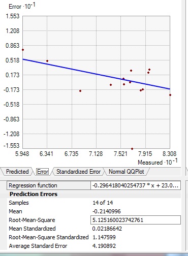

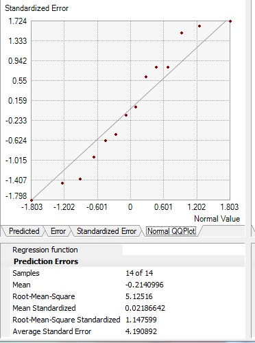

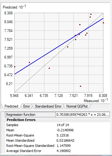

I now have the chance to do kriging on sparse weather data. Here's a sample of the kriging surface using 14 data points of relative humidity.
And here's some statistical modelling results:
I used ordinary krigining without changing other settings in the ArcGIS.
While not ideal, the results seem to be not so bad either--the standardised root-mean-square is moderately larger than 1, the average standard error is also moderately different from root-mean-square. What do you think about the results and any suggestions for improvement?
Many thanks,
Sui
