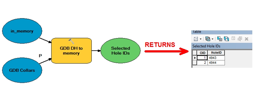

I want to create a SQL expression based on records selected by the user.
For example my input table has only one column "HOLEID" with two records "4943" and "4944" (string).
I want to iterate through that table to generate the following SQL expression : "HOLEID" IN ('4943','4944') .
I'll then store that expression in a variable and use it in several places to select and delete records in other tables.

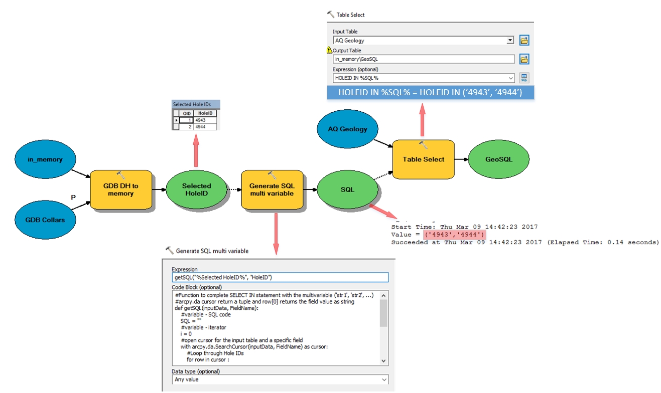

MetralAlexis
What’s good with ESRI’s forum it that I rarely get an answer and I’m forced to solve it myself and progress.
So here is the answer and that was actually very simple, I describe my workaround below.
Block code used for the Calculate Value tool :
#Function to complete SELECT IN statement with the multivariable ('str1', 'str2', ...)
#arcpy.da cursor return a tuple and row[0] returns the field value as string
def getSQL(inputData, FieldName):
    #variable - SQL code
    SQL = ""
    #variable - iterator
    i = 0
    #open cursor for the input table and a specific field
    with arcpy.da.SearchCursor(inputData, FieldName) as cursor:
        #Loop through Hole IDs
        for row in cursor :
            i = i + 1
            #If first row, start SQL code
            if i == 1:
                SQL = "('" + row[0]
            #Otherwise keep completing the SQL code
            else:
                SQL = SQL + "','" + row[0]
    #Close the SQL code after being out of the table
    SQL = SQL + "')"
    #return SQL code to the model
    return SQL
It looks the most practical solution to me after my researches. However, I have a basic knolwedge of Python and if anyone has something better, please let us know, I’m not sure that the most elegant way to do that.

MetralAlexis
Hi Curtis,
Thanks, indeed, your code is way better than mine, I'll update that in my model
And true, I need to get more familiarized with GeoNet, I'll be more carefully next time.
Thanks for your input.
