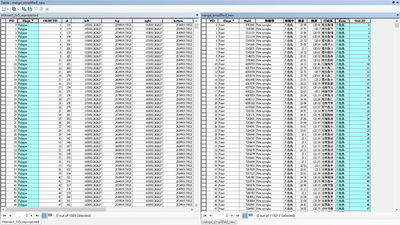

I must say I'm an absolute beginner to python in GIS, mostly using the default functions for analysis. During the process several problems occurred.
1. Assuming the 'PathToOutputTalbe' is a variable where the table should be generated, So I created an empty file for it, but I'm not so sure about it.
2. It returns this error message, and generates almost a blank table as a result.
Runtime error
  File "<string>", line 30, in <module>
SystemError: error return without exception set
3. Also, I might not be descriptive enough that the grid layer is actually a polygon, which should have its spacial value showed in the final result so I can visualize it on the map. In my case it's the 'left', 'right', 'top', 'bottom' column I assume.
I came up with the idea that can I simply generate 4 fields, but it didnt work as expected.
arcpy.management.AddField(out_table, "Left", "FLOAT")
arcpy.management.AddField(out_table, "Right", "FLOAT")
arcpy.management.AddField(out_table, "Top", "FLOAT")
arcpy.management.AddField(out_table, "Bottom", "FLOAT")
  At this point I might just post my original working table for your better understanding.  The desired result is that I can clink on a polygon, and read how many 'Names' are there in the selected polygon. Thank you and sorry for the dumb questions.

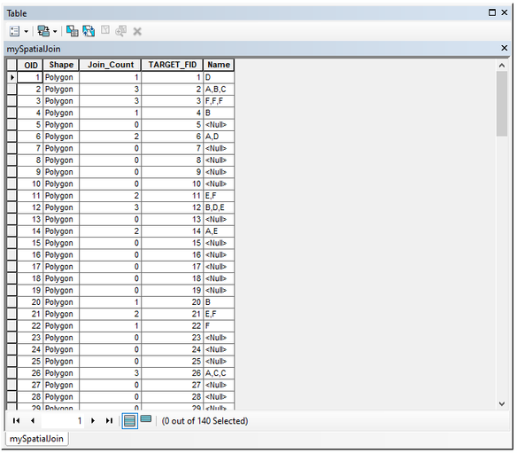

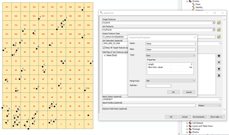

Absolutely NO CODE is required to answer this question just a little knowledge on the correct usage of the SPATIAL JOIN tool.
The trick is to set the Merge rule to JOIN on your Name field in the field mapping as shown below. Also adjust field length as required.
The output is a new FeatureClass grid with join count and concatenation of values from your Name field, see example below.
Any code is overkill and I suspect slower if your datasets get very large.
