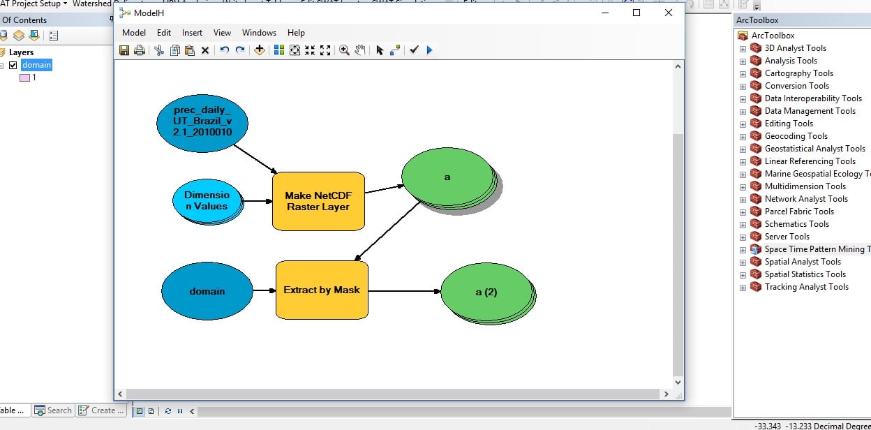

I have a single NetCDF file that contains daily precipitation data for several years and would like to extract them in a more automatic way.
I am aware I could do it by creating an model builder and within "make netcdf raster layer" make the dimension values variable. However when I add a quite a lot of dimension values, model builder keeps crashing.
That is a print screen of my model:
