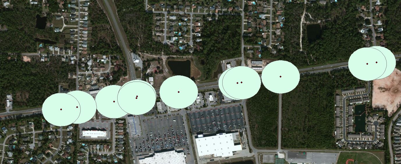

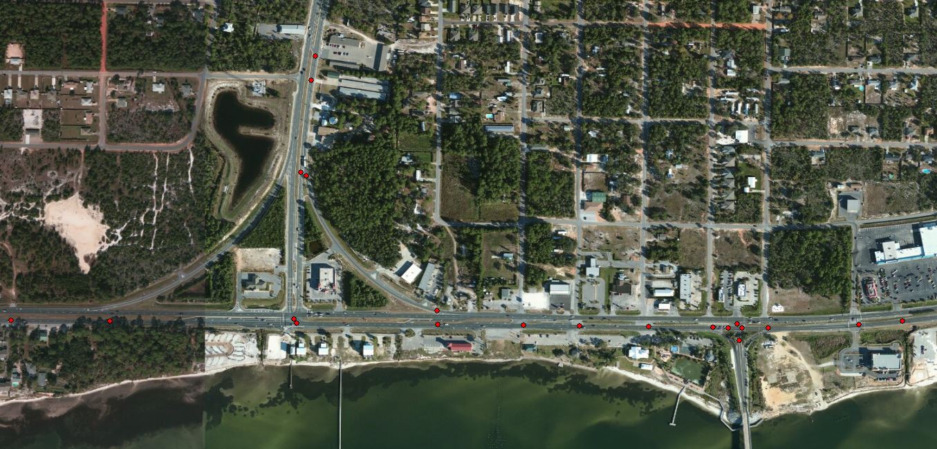

I been given an assignment to group accidents that are near a intersection. I was given three shape files one for signal intersections, all intersections and accidents along the road for one county.
The problem that I am running into is overlapping buffers at the intersections. I am doing 250 feet buffers at the intersection. The reason for this is some intersections are too close to each other.
The data that was given to me for intersections are broken into two or more dots one for traffic going left and the other for traffic going right at the same intersection. How can I get these two dots to join through out the whole county instead of doing it one by one.

Would it be possible to merge or append the buffers into a single polygon layer, then use that polygon layer to spatially join to the accident point layer?
ElizabethPutnam
I did dissolve and then feature to point and did the buffer again and join my data. Thanks.

Elizabeth
if you turn the dissolve type to all in the buffer tool this will do the process in a single step.
regards
Anthony
ElizabethPutnam
I looked into it and yes this saves a lot of steps. Thanks.
I'm having some data counts duplicated on my buffers that are overlapping. What could I do to avoid duplicate counts. I could make the buffer distance smaller but then the dots will not be included in either buffer.
Thanks.

ElizabethPutnam
This is what I am getting. The dots are being counted in each buffer and if they overlap they are counted in both buffers. Thanks for your help.
JoeBorgione
MVP Emeritus
That's what I mean:  the buffers are goofing on you; if you do a straight up Near analysis, I'm thinking you should be good to go...

ElizabethPutnam
Is there a tool where you can get the nearest/closest crashes that were not picked up by the buffer to be included in the nearest/closest buffer.
Thanks.
JoeBorgione
MVP Emeritus
drum roll... Near Tool but it's only available that the highest license level.  I don't know what ESRI calls it but I call it ArcInfo. Also, the Point Distance tool may do it too...
