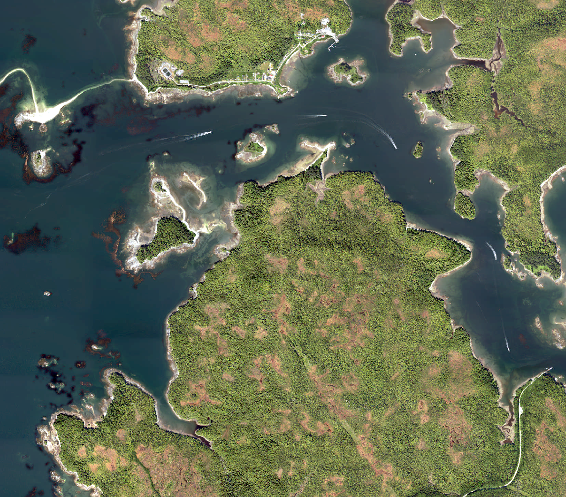

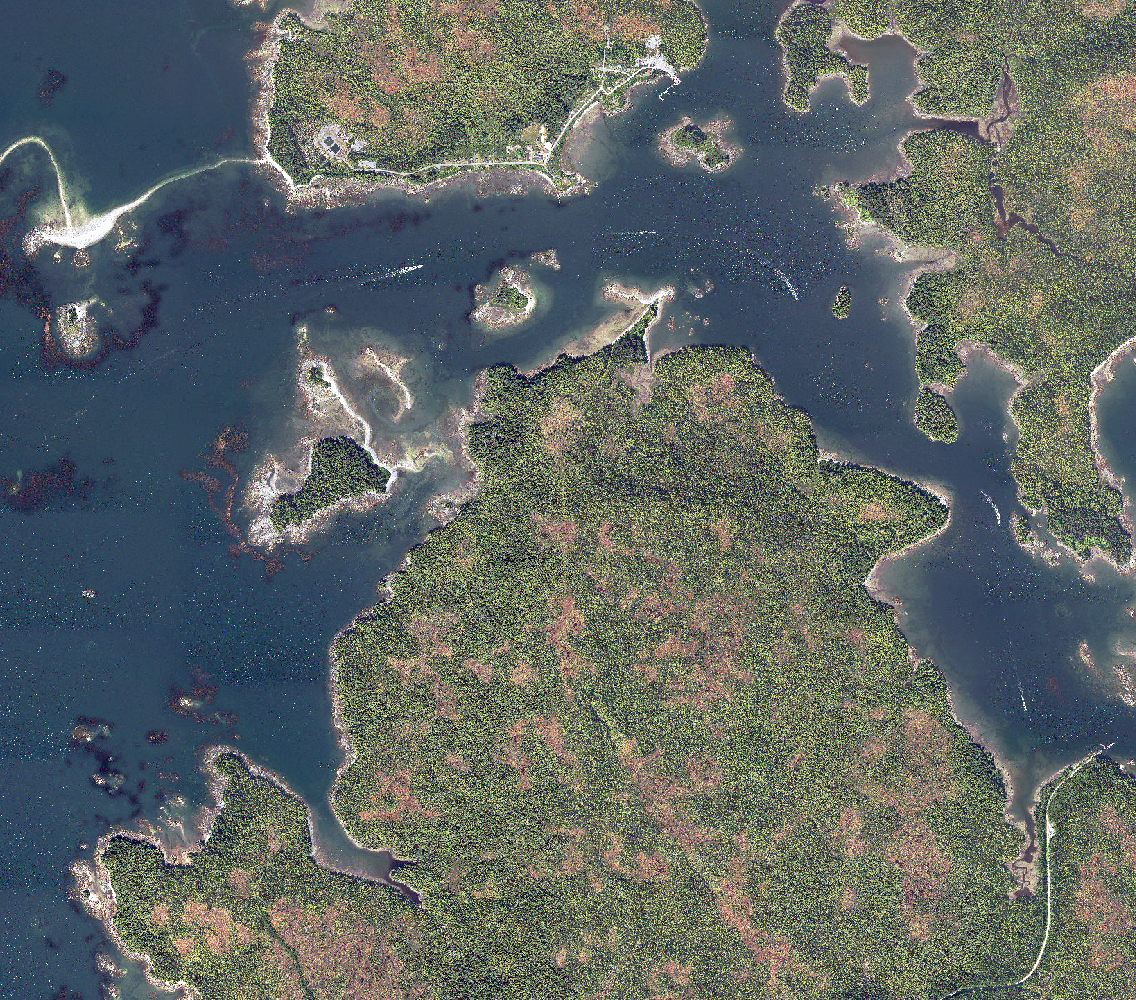

I have been trying to clip an image using ArcGIS Pro (2.3). I need to send this image to a 3rd party, so it's not going to be used in my system.  I am simply trying to convert an ESRI GRID format image into a smaller ESRI GRID format image.  I have tried various geoprocessing tools:
  • Extract by Mask
  • Clip (using a polygon)
  • Copy Raster (after using clip in Raster Functions)
And have used various compression settings:
  • LZ77
  • JPEG
  • LZW
I also always let the software build pyramids using the -1 option, and have tried setting "no data" to both "0" and "256".  I have not changed the projection.
None of my methods seem to work and in every case the resulting image appears coarse and no like the original at all.  All I want to be able to do is capture a piece of our high-res orthophoto and preserve the original image quality in the resulting image, which sounds fairly straight forward.
Because each iteration of my workflow takes about 15 minutes this project is starting to cost me hours...even days.  Surely there's a smart way to deal with this, right?
Original Image
Resulting Image
Suggestions?
Thank you

I'd recommend trying NOT using 0 as a NoData value - that might be why you are getting those "speckles" in the dark water areas.  Those look like they might be valid black 0 values within the image.  Once you've done that, make sure that the #Raster Layer Appearance Stretch Type is set to None.

I tried processing this clipped imaged 3 different ways using just the default settings, but it sill produced the same grainy coarse results (as per below).  This is very frustrating. I tried Clip Raster using my polygon, Copy Raster, and then Clip from Raster Functions using the Export Raster option...all with just the default settings, but nothing seems to change.
I'm wondering if there is a default setting somewhere that is overriding my process each time?  I say this because no matter what settings I use the results never seem to change regardless of what compression method was selected, which to me seems odd.

Interestingly, with exception to the resolution over the water, when I zoom in to a larger scale I cannot see the coarseness anymore...it's only at the smaller scales where this becomes more obvious.

"...when I zoom in to a larger scale I cannot see the coarseness anymore...it's only at the smaller scales where this becomes more obvious."  Now that is very interesting and suggests that maybe the clipped raster is actually okay and the problem may lay with display of the image.
If you right-click the raster, click "Zoom to Source Resolution", and the clipped image looks good at that scale (indistinguishable from the original), then it seems possible this is a display re-sampling issue, not a data issue.
Maybe there is a problem with your pyramids.  I'd suggest trying two things:
1) Delete the pyramids on the clipped raster and see what it looks like without pyramids.  Right-click the raster in Catalog, Build Pyramids, then use "0" for Pyramid levels.  This deletes the pyramids.
2) If deleting the pyramids is no good, try re-building them.  Same steps as in 1), but use -1 for Pyramid levels to build full pyramids.

Thanks again...this gives me an opportunity to explore a different angle to this problem.  I will work on this today and see what happens.  The latest version of the clipped images is 1 GB...it's a fraction of the original (10 cm resolution), so if I could share that somehow I would.  However, I did take a peek at it using the "Zoom to Source Resolution" and it pretty well substantiates my observation on the coarseness disappearing when zoomed in.  The clipped image is to the right of the red line:
This is a snapshot of what it looks like when I zoom out to 1:30,000 scale:

So what I did was create a new Mosaic using those 9 TIFF images, but instead of using an 8-bit unsigned pixel type I used a 64-bit instead, and it works perfectly.  The new image is virtually indistinguishable from the original:

Your pyramids (reduced resolution overviews) are being generated using "nearest" resampling.  Use "bilinear" or "cubic" instead.
Your clipped data is probably also being displayed with a different stretch to your original data.  If the data is 8bit RGB and doesn't need stretching, ensure the stretch type is set to None for the clipped layer symbology (it defaults to a percent clip stretch).  If the data is 16bit or something else, it needs stretching for display and ArcGIS relies on band statistics to do the stretch, you'll have to manually set the clipped image statistics (for display only in the layer symbology) to be the same as the original layer.  However, you don't really need to do this, if you're not going to be using the data, just sending it to someone else.
