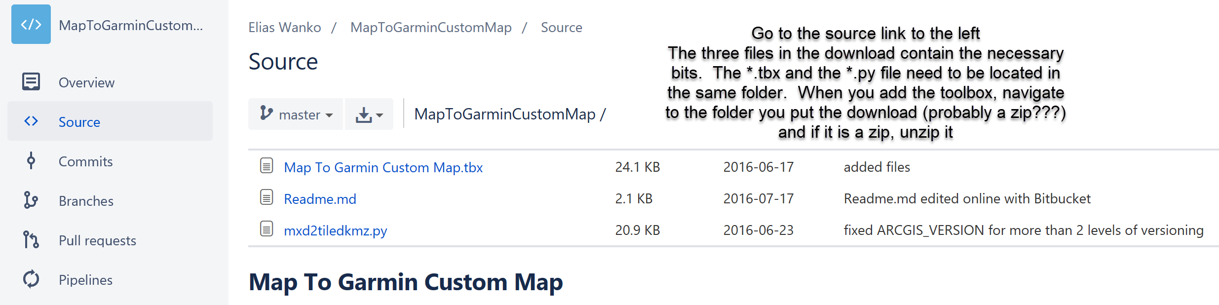

I found a MapToGarminCustomMap
<https://bitbucket.org/wankoelias/maptogarmincustommap>
tool, downloaded it added it to my tool box but it tells me the tool does
not exist.
Any ideas?
DanPatterson_Retired
MVP Emeritus
Jane
I didn't download the file, but I went to "Source" link to see what was there.
Here is my visual summary
janehansen
Got it to work, thanks for your help Dan
MVP Emeritus
glad it worked out Jane
