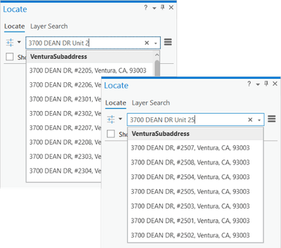

Here is what I expect the results to be where in this example they actually use a keyword Unit, but I don't believe that is even necessary.  Using type ahead, 3700 Dean Dr. should return all the choices.

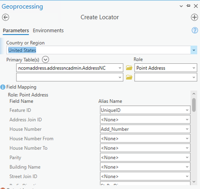

For the Create Locator tool:
  • if you have buildings, use the BUILDING input not the BUILDING NAME input
  • specify a POINT ADDRESS role if you have points that represent the location

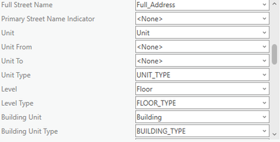

  • if you want better return for the type of unit, e.g. Unit, Suite, Apartment, populate a field to store those values and reference that field in the row for UNIT TYPE

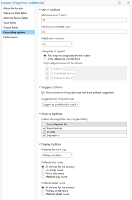

  • After your locator is created, examine the Locator Properties under Geocoding Options.  Make sure all the boxes are checked for Subaddress.  Also for type ahead performance, I use “Suggest as partial unit is typed”
  • For interactive Locate within Pro or through a webmap, (https://nconemap.maps.arcgis.com/apps/instant/media/index.html?appid=c51b8ef4c4334835807a2850b7daa85...) add on a number in your type ahead to retrieve sub units (for example at type “215 n pine 1” to return many returns where the unit number begins with 1
  • For interactive Locate within Pro, make sure “Show All Candidates” is checked

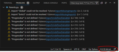

I'm having issues with the Global and boto3 modules.  The "ProgressBar" too but I'm less worried about that at the moment.  See errors below.  Running Python version 3.9.18.  I will try to do more research on it this evening try again tomorrow.  Thanks for the assistance.  I'm fairly new to python.
Darrin-Smith
Keep in mind, this code is just one part of thousands of lines to accomplish many specific tasks.  The imports at the top of the script are just residual for my purposes.  I would say you can delete all those lines except for import arcpy and possibly import datetime as time is reported through the script.  If you look at the INPUTS/OUTPUTS near the top, I tried to give you an idea of variables used in the script.  I retain all my variables in Global hence the import statement you are having issues with.  You will need to define your local variables and my recommendation would be to use the ones I have to do so.  For example, the variable for "in_layer_name_path" should point to your featureclass for all your address points.  You'll also find I use fields you might not have and schema's I use that might not be applicable.  At a minimum, to resolve geocoding issues with sub addresses, you need to create a faux point that has a parent and append that point to your master set and then run the Create Locator on that set in order to account for the parent.  My script will tell which points don't have parents.  Then your geocode result should give you options for the parent sub addresses.  My script goes one step further to actually determine where the mean center of the faux point should be based on proximity to all the sub addresses.  Hope this helps.
