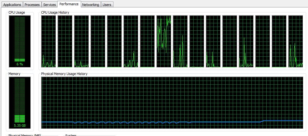

Hi,
We use the tool "Manage Tile Cache" in ArcMap 10.5, for ArcGIS Server 10.3.
Parameter "area_of_interest" is the feature class created by CacheWorx "Coverage To Feature" Level 19
The help says: "For the fastest tile creation, your CPU should be working near 100% during the tile creation"
Having 16 cores CPU, and using ParallelProcessingFactor 100% or 16
the CPU usage is very low - between 3 to 8 percents
Any help will be greatly appreciated.
MarkMindlin
We figured out the one reason: area of interest was the feature class with number of polygons more than 1.
After we have dissolved the feature class it seems better: now, 20-30% of CPU usage (still not 90-100 )

AnthonyMikelson
I just upgraded from 10.4.1 to 10.5 and it appears the Manage Tile Cache geoprocessing tool is not respecting the multithreading like it is supposed to.  In 10.4.1 if you had parallel processing set to 100% then the amount of ArcSOCP should match the number of cores.
Since upgrading to 10.5 I do not see any ArcSOCP processes at all and the caching appears to be much slower.
MarkMindlin
Anthony, thank you for your response. We use 10.5, and 16 ArcSOCP processes for 16 core CPU are present.
Another indication of the "proper" use of the tool is number of temporary  *.lock" files in the cache folder.
AnthonyMikelson
After further research I had to eventually uninstall the Desktop Background Geoprocessing.  Not sure why yet, but it is working now.
MarkMindlin
We also uninstalled Desktop Background Geoprocessing.
