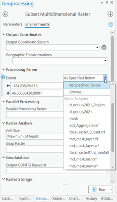

Hello Andrea. My name is Yu Wang, a Product Engineer from Spatial Analyst team. As you mentioned in your thread, you are using a multidimensional raster layer, however, “Extract by Mask” tool does not support multidimensional input. When you have a multidimensional raster data as input, only the first slice will be processed. The proper tool is to use the Subset Multidimensional Raster tool and set the extent using your mask data. Here are two pictures showing the process:
Please let me know if you have any questions.

I just tried it, but if I use a polygon Layer as a Country border it is not working.
The extent stays the same like the raster extent.
Thanks in advance!

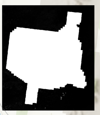

@YuWang1   I am trying to do this also and it is not working.  The extent just goes to a bounding box so if the area I want is not square it does not work.  Any ideas?  This is a common issue with Esri tools it seems assuming squares all the time.
I am trying to combine two CRF files with a different extent but perfectly aligned at the cell level.  Been trying everything.  Snap raster does not do it either.
thanks
