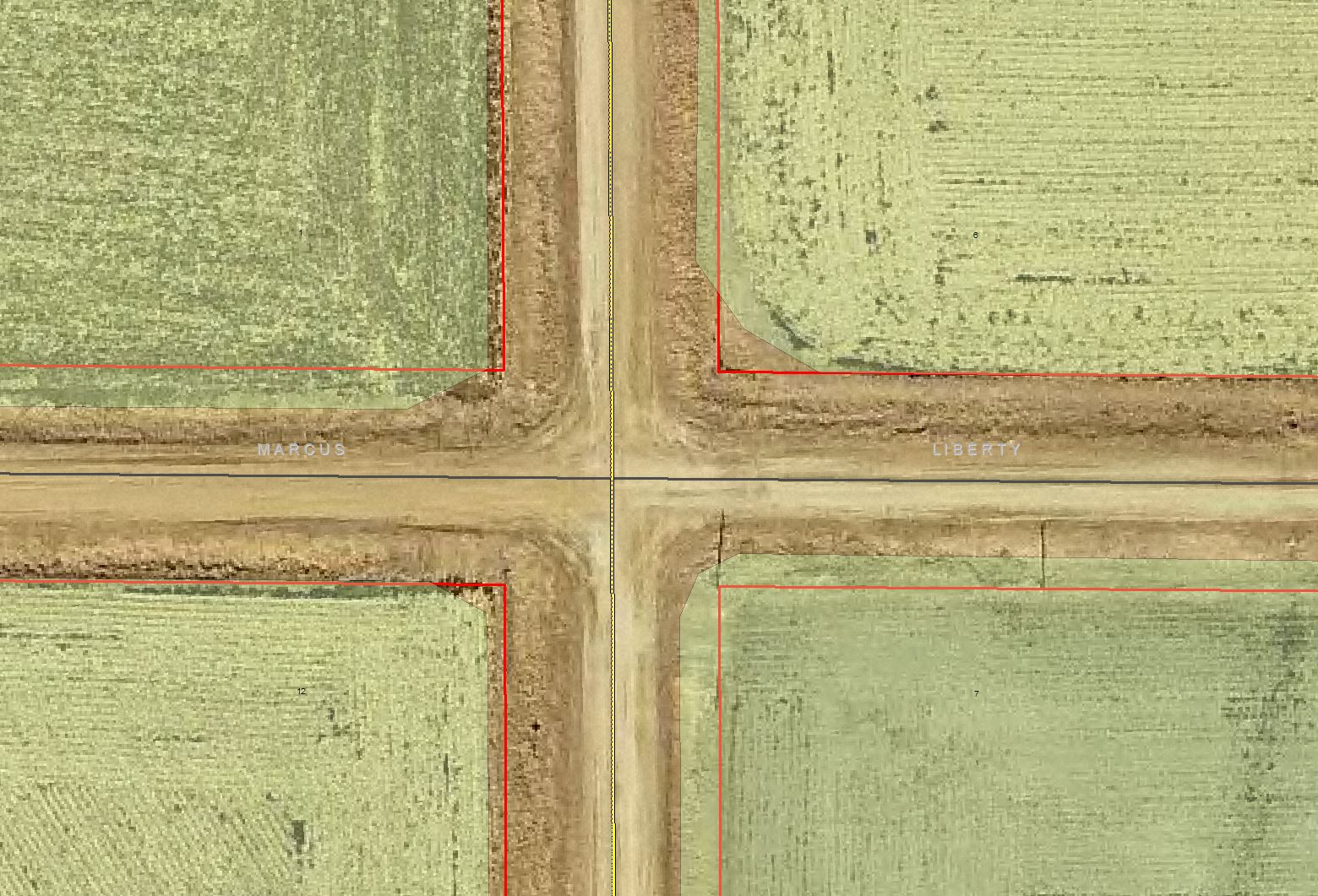

I am looking for a good way to 'fill the gaps' between my county's polygon layer and a land use layer I inherited.Temp.JPG
I need the green symbolized land use polygons to, at the very least, overlap the red lined parcel polygons. There are several thousands of this example throughout my county and I would like to avoid correcting them by hand if I can. Does anyone have a solution or tool for my situation? Thank you!

There appears to be no pattern in the sample image that you submitted, suggesting that these are the artifacts of manual digitizing.  If this is indeed representative of the pattern throughout your image, I can't think of anything offhand that would take spatially random displacements/mis-shapes and get everything back to where you want it to be.  Should you be able to identify a particular shift in one direction, then it may be due to a projection/datum issue.  If not and the shapes are randomly different, then nothing can take randomness and impose order.

I'm doing something similar for my City's Land Use layer, where most of the Land Use extents are parcel based.  If I am reading your request correctly, you need to get the green Land Use polys at minimum to extend as far as the red Parcel polygons.  While not an automated/instant solution, this suggested process will identify the issues areas where your landuse polys do not extend as far as the parcels and provide some spatial material to quickly fix some of them without having to redraw them:
