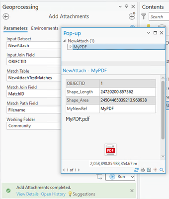

Hello @jgideon_grs  , this is what I tried with ArcGIS Pro 3.7, but I did not see any problems.
1. I have a Feature Class in a File Geodatabase.
2. I run Enable Attachments on the Feature Class which creates the ATTACH & REL tables.
3. Using Generate Attachment Match Table I create the match table which does contain the correct matches.
4. Then I run Add Attachments to add the attachments to the Feature Class as expected.
Are you able to post any alternative steps to reproduce the problem ?
