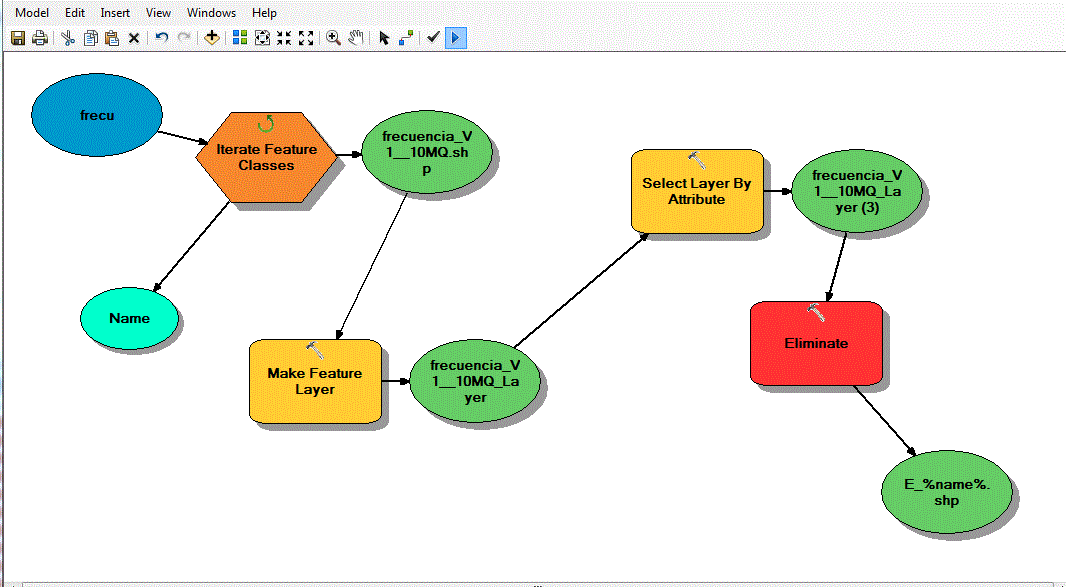

camilogarcia
model Eliminate Tool
insert after  iterator, tool "make Feature Layer" an done
