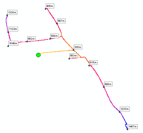

The below image gives an example of the three feature classes that I have.  The one contains multiple points that are all routed back to a single "hub" location via a line feature class.  I need an output that measures the line distance back to that "hub" location from each individual point feature.

Here's my five minute solution:
1.) Add and calculate a field in your fiber feature class to equal 1 for all rows.
2.) Convert to raster (requires Spatial Analyst, I believe), using new column as value. Now have fiber raster layer, all with value = 1.
3.) Run Cost Distance tool (requires Spatial Analyst), using new raster as cost surface and hub as source.
4.) Extract resulting cost distance values to node points. This will only transfer distances to nodes if they happen to fall on the fiber raster. If not, need to edit nodes so they fall on raster and rerun.
This was done somewhat naively, not knowing if there are geometrical consequences calculating continuous distances between square pixels, but the values seem reasonable.
