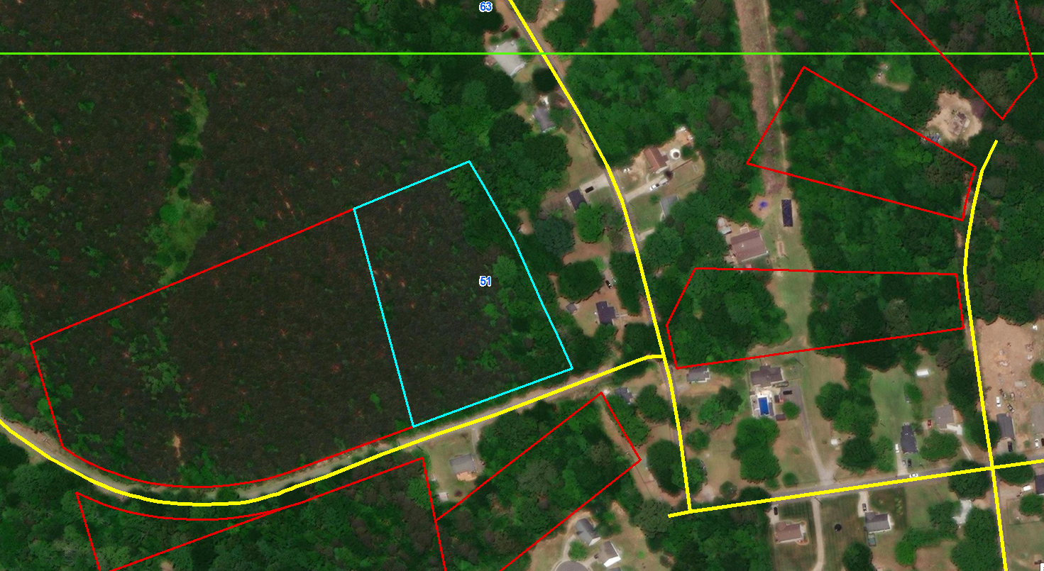

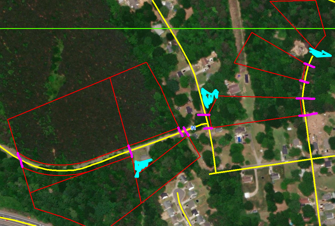

1) Maybe make a buffer around the parcels and determine frontage from whatever length of road falls within that. There is at least one problem that come with doing this however, a) how far to buffer? if I buffer too far that could be bad, but not far enough and it's also a bad result. b) A Buffer does not extend straight out from edges of the parcel so the measurements using a buffer will not be precise enough to rely on. E.g. I would need to extend lines from the corners of parcels such as the pink lines in the screen shot below to measure the precise road frontage of a parcel and at the same time I would not want to include parcels that are too far from the road such as the cyan light blue scribble areas.

This is a screen shot of just some parcels to help with the thought process.
