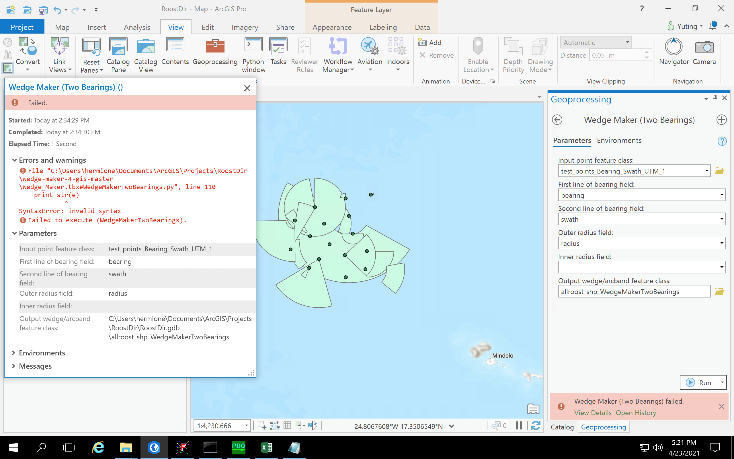

While I am using the test example file for this tool, trying to create what they have created (you can see it open up in the following image), I constantly run into an error:
I'm currently using ArcGIS Pro 2.7.0. Don't know if it's a version issue.
Any idea about how to fix the problem? Any advice would be much appreciated.
DanPatterson
MVP Esteemed Contributor
t was obviously developed in python 2.7.
Pro uses python 3,
Solution, open up the script in a python IDE or if desperate, a text editor. and replace all print statements with
print "stuff"   # ----- wrong
print("stuff")  # ----- right ...  note the brackets
hopefully there isn't too many python 2 to 3 issues, otherwise it may a more painful process
