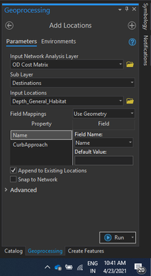

Hi Roxana,
I believe you have two sets of inputs one is polyline(Street datasets) and point datasets. If I understood perfectly your requirement is to find the distance between two points.
Step a: Build your street layer as a network dataset.
Step b: Create OD Cost Matrix using Network Analyst Extension in ArcGIS Pro
Step c:  In Pro, Contents pane select OD Cost Matrix Origin layer, Once you select the origin layer you will see the OD Cost Matrix tab got highlight in the Pro ribbon.  Go to the Input data Import destination option and import your point cluster datasets in input locations and sub-layer as a destination under the Add locations geoprocessing tools and run (refer below screenshot).
Output result between two-point features.

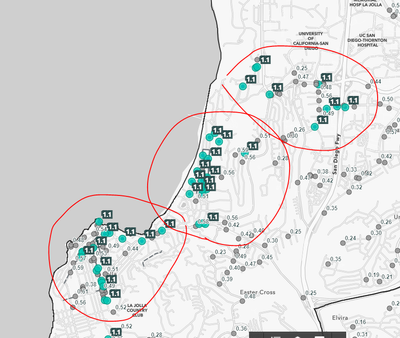

Hi @Roxana_ElenaUrdea did you ever find a way of doing this?
We are running some parameters to come up with a priority scoring and then clustering for a maintenance backlog. We can use an as-the-crow-flies distance buffer but would be really cool to instead group into clusters based on a drive time using a network to be smarter about it (we have a lot of canyons here that can massively increase drive time!)
Something like...
Thanks for asking this.
