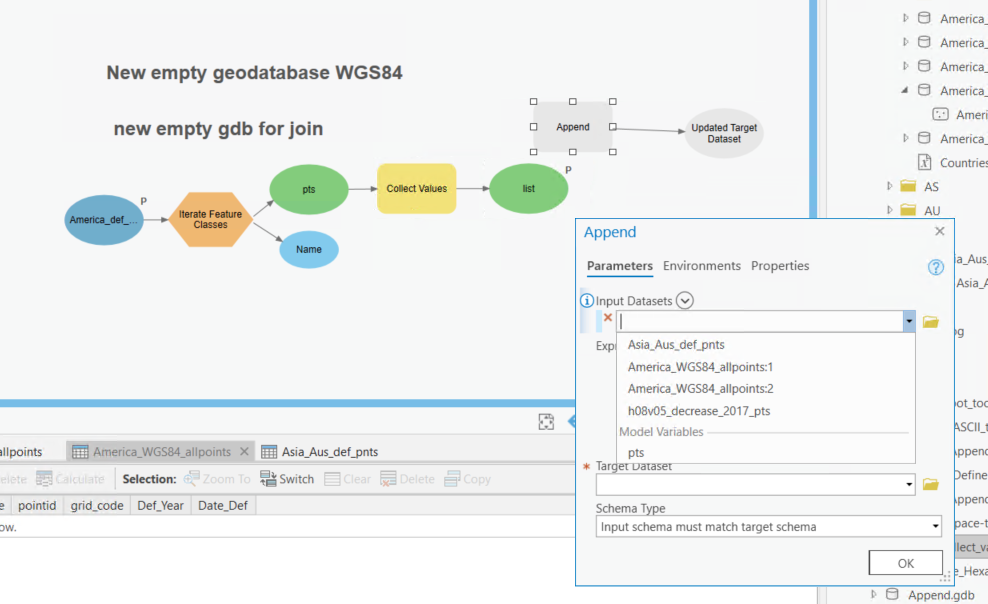

I am trying to append many individual feature classes in a geodatabase into one singe feature class in a different geodatabase using modelbuilder.
I created a collect values model, and inserted it into an append model (you just drag and drop?? in arcMap you could add sub-models), the collect values just lands in the model, but I cannot attach it to either append or merge tool - the input list is not recognized. And since arcGIS pro does not have the connector tool you can't connect one output to tool.
I have also tried iterate datasets, but have the same problem. I am following what is described in the help - collect values into a list and then append (https://pro.arcgis.com/en/pro-app/tool-reference/modelbuilder-toolbox/collect-values.htm) Can anyone help?

JohannesBierer
Du you really need the collect value step? Wouldn't it be enough to iterate feature classes and then append?

AurelieShapiro
That is also a great question - why does the arcGIS help say to collect values? When I just put everything into merge or append it does not take the entire spatial extent of all features (although I specify the large extent when I create the geodatabase to receive the append features...)
JohannesBierer
Don't know. I have used it without and it worked for me?
JohannesBierer
To the spatial extent question I have no idea. The only thing is maybe to use the recalculate-feature-class-extent tool?
