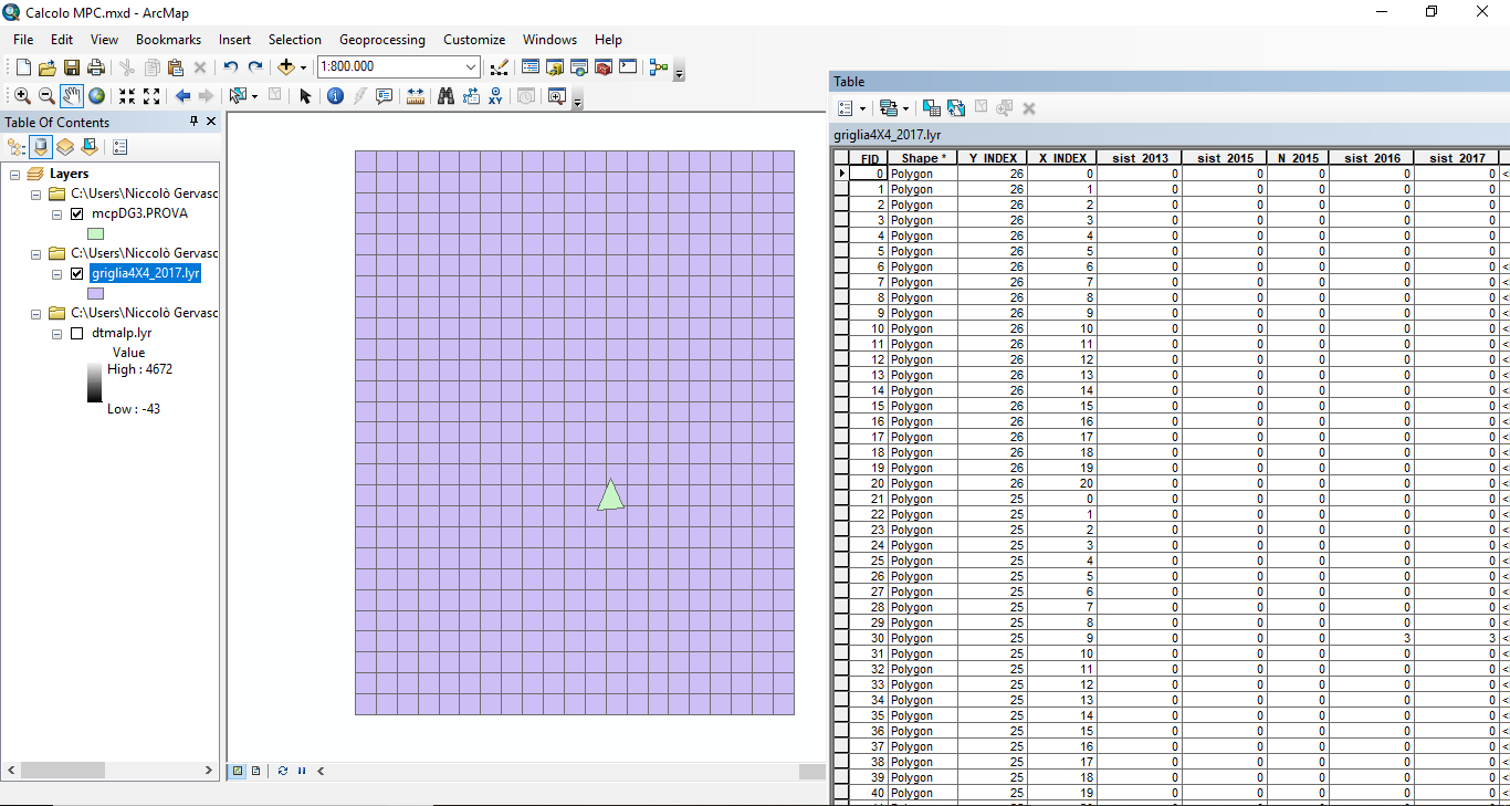

Got it. I have another problem. My shapefile "griglia4x4" is like this:
while I need it to be only one polygon, with only one area. How can I trasform it?
DarrenWiens2
MVP Alum
See Dissolve. If memory serves, don't fill in a field to dissolve by to get a single feature (but, you may have to create a new dummy field and populate with a single value and dissolve on that).

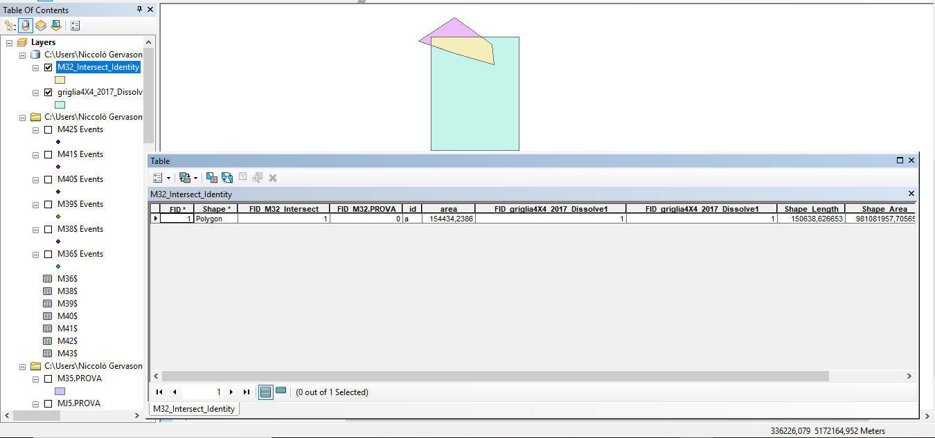

Hi,
I used identity (but I also tried with intersect and it's the same).
Instead of getting a new polygon with its area in the attribute table, I get this:
I need to know the area of the intersect...
DarrenWiens2
MVP Alum
Calculate the area of the yellow polygon into a new field. Calculating area, length, and other geometric properties—Help | ArcGIS for Desktop
