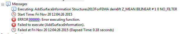

Transferring the values from the raster to the polygons should be a straight forward operation using add surface information but that tool is useless and returns a 99999 error code.

Even though you got the dreaded 9's have you examined the report in the Result window? (customize, results, then examine the tree, particularly your inputs, environments and message)
GerryGabrisch
Yes, Dan, I have.  The input parameters are good, there is no other information other than what is shown below.Capture.PNG
