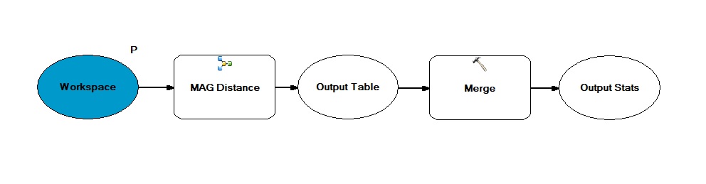

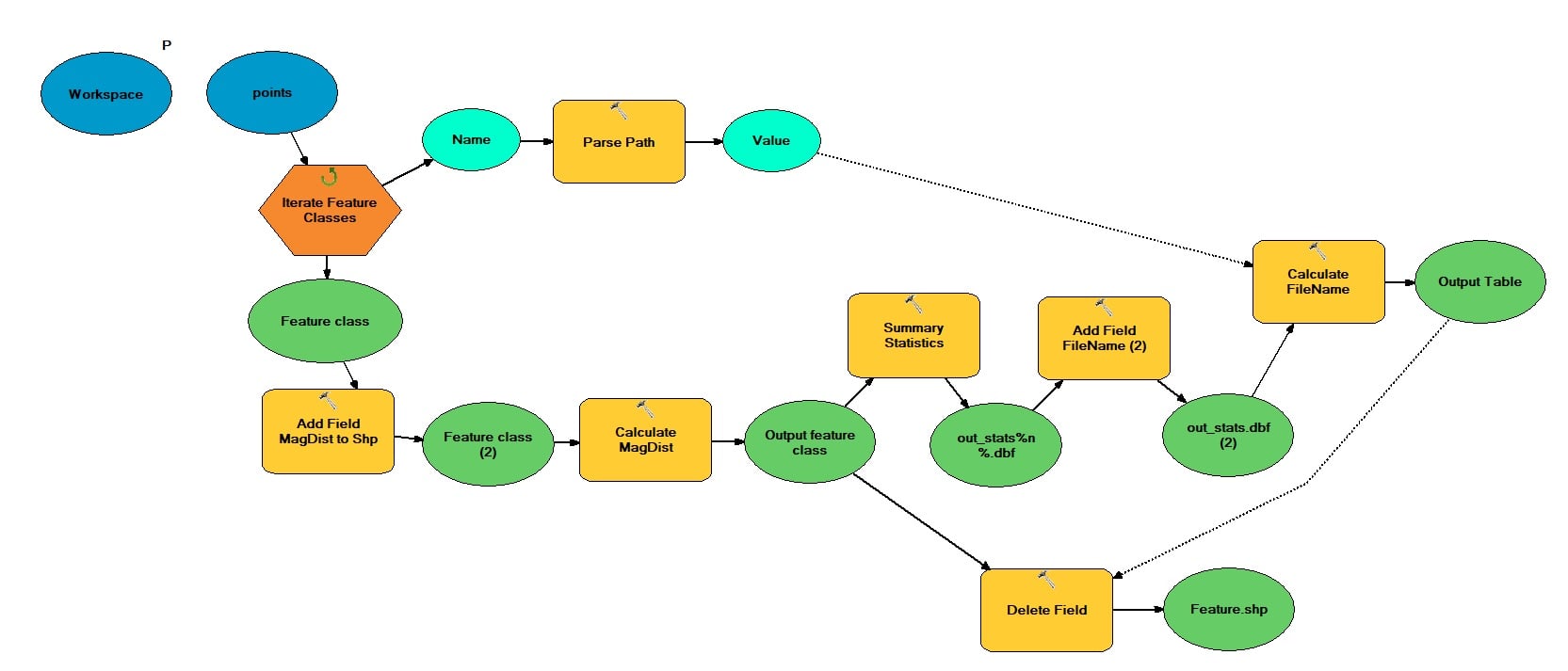

I am running a model iterating through N feature clases and I get N tables as output. The model works properly. Here it is:
I need to merge this tables into a new one, thus I would run my model as submodel. However, when I add it to the new model something goes wrong:
I am still learning modelling and programming skills, thus any help, suggestions, clarifications are more than welcome!

Thanks for your suggestion. The first model works properly and returns N output tables; if I apply the merge tool to the output tables it works, too, but for some reason I cannot combine the two into one model in order to automatize the process.
There was a similar question some time ago (Merge all iteration output to single output in modelbuilder), but it doesn't work either.

You are almost correct. You have correctly identified that your main model with the iterator needs to be a sub-model in a model with a single Merge tool. Merge takes a LIST of inputs which you merge. So how do you create a LIST of tables? There is the model only COLLECTS VALUES tool. Tag that to the end of your output table IN you sub-model and expose it's output as a parameter. Drag that sub-model into a new model with just a merge tool and you will see that the sub model has a LIST output which simply connects to the input parameter of Merge.
SerenaFraccascia
Thanks for your suggestion! It still doesn't work, as it seems that the fact that during the model the variable 'out_stats_%N%.dbf' is manipulated several times generates some kind of conflict when I run it as submodel. I cannot set them as intermediate variable (which I guess would solve the problem); I have read in some other post that that would be possible by setting the environment, but I am not so far with Model Builder and I would not know what to change. I would be very grateful if you could help me!
DuncanHornby
MVP Notable Contributor
You need to show us how you are running the summary statistics tool for anyone to comment. Add a screen shot of how the parameters have been set.
SerenaFraccascia
From the statistics I only need the mean value:
DuncanHornby
What does %workspace% equate to, that could be the problem?
SerenaFraccascia
That's the workspace where the original tables are located.
