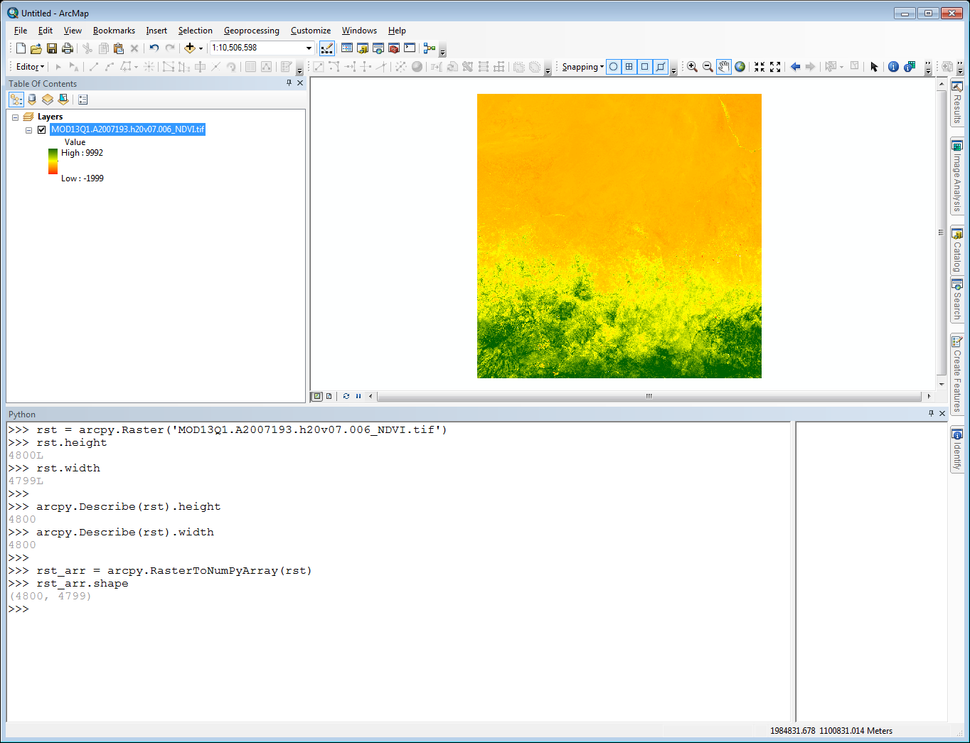

I am executing arcpy commands from the python window in ArcMap 10.41. I am creating an arcpy Raster object using a raster layer from the table of contents. I want to then convert the raster object to a numpy array object so that I can run it through some scripted routines resulting in a raster output. With that said, I've noticed some odd behavior when creating the arcpy Raster object which seems to impact the creation of the numpy array object.

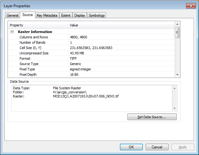

The properties for the input raster layer are below. Note that the number of columns and rows is 4800 each.
After creating the raster object in the python window, I took a look at the height (rst.height) and width (rst.width) properties. To my surprise, they did not match. However, when I execute 'arcpy.Describe(rst).height' and 'arcpy.Describe(rst).width' I get 4800 for both (See image below). Can anyone explain this behavior?
Additionally, when I convert the raster object to a numpy array is get the dimensions (4800, 4799) which then carries over into any raster I make.
In the case of this raster layer, I'm losing the far right column during the conversions. In some over cases, I'm losing the bottom row of the raster layer. Initially I assumed the problem had something to do with the precision of the lat/lon values in the lower-left corner. After adjusting those I was able to get the correct number of rows and columns, but the data for the row or column that was missing initially was filled with nodata values.
Has anyone experienced and/or solved this before?

I am converting the raster to a numpy array using the arcpy's RasterToNumpyArray function. During that conversion is where I lose the row and the data it contains. At the moment I am restricted to using arcpy and numpy to do the conversion, and I don't want to add any more dependencies to ArcGIS tool I'm developing. Is there a way to add the raster data values to an empty array without using the RasterToNumpyArray function?
I did just notice something with the arcpy raster object...when I run the command 'rst.width'  I get '4799L'. However, if I pick a point from column 4800 from the image in my display and request the cell value for that point from my raster object (rst), I get the correct data value in return. So, while the raster object properties says it's of length 4799, the object still contains data values for column 4800. However those data values are not being transfer into the numpy array.
