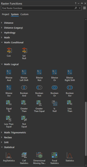

JohnWatt
I love raster analysis, and it might work well here. You'd need to convert the three layers to coded raster layers, but once done you can use Raster Calculator (or Spatial Analyst GP tools) to do all kinds of number-running.  Raster calculator is great as it is non-destructive and very fast, which helps with learning and pattern detection.  eg Veg class change could be a simple Not Equal - will give a matrix with "1" where there is change, and '0' where there is not.  Run twice (60s/90s and 90s/20s) and add results together to get a matix of 0(no change) 1(one change in class) or 2 (two changes in class)
