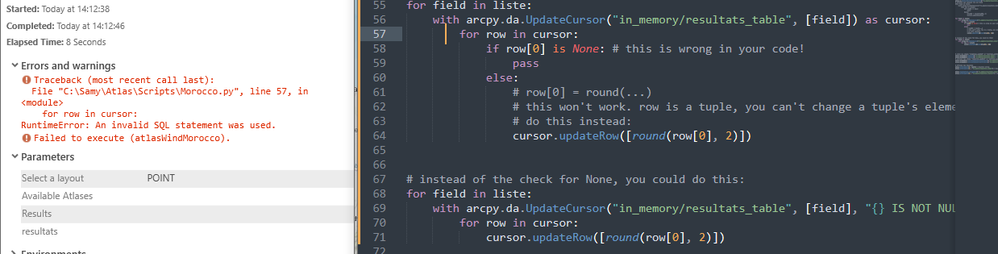

hamidmechouet
thanck you for your help johannes, but i have the same error.same_error.PNGsame_error.PNG
DanPatterson
MVP Esteemed Contributor
That is because you left in your old code (lines 55-64) and didn't use the suggested code beginning at line 67.
