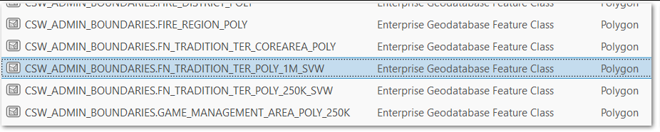

What specfically is a "database feature class", as distinct from "feature class"?
For example in Catalog here we see 3 layers in an enterprise sql server geodatabase. The bottom and top ones are regular polyon feature classes created the regular way. The middle one is also a polygon layer, but is created with the Create Database View geoprocessing tool.
All 3 of them can be added to a Map in Pro and they behave identically in the map as far as we can tell for symbology, labelling, selection, etc.
Why does Catalog not see the view as Polygon type?
In another ent-gdb I have access that is oracle hosted instead of sql server there are spatial view layers, but they area seen the same as normal FC. I don't know how these oracle spatial views were created.
How do we get our sql server database views to be recognised as layers with geometry types before adding them to a map?

As often happens, the process of properly writing a question reveals a path to the answer. In this case: look a the metadata for the oracle spatial view and see of the Processing History has useful information. It does!
Geoprocessing history
Process
Process name
...snip...
Command issued:
RegisterWithGeodatabase "Database Connections\..."
which leads us to Register With Geodatabase:
Registers feature classes, tables, views, and raster layers with the geodatabase. Registering is used for data created in the database with third-party tools using SQL or in ArcGIS Pro with tools that do not register with the geodatabase (Create Unregistered Feature Class, Create Unregistered Table, and Create Database View tools).
Only limited functionality is available from ArcGIS clients and services for data is that is not registered. Registration stores information about the items—such as table and column names, spatial extent, and geometry type—in the geodatabase's system tables. This allows the registered items to participate in geodatabase functionality.
