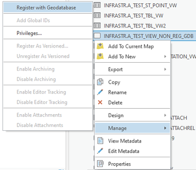

I've created a database view using SQL Developer. The view is not registered with the geodatabase.
I can see that the view isn't registered by right-clicking on the item in the Catalog Pane. The fact that the Register with Geodatabase option is not greyed out tells me that it's not yet registered.
That works as expected.

The Icon in catalog indicates whether or not a view is registered with an enterprise geodatabase. When the icon is an empty rectangle like in your original image, the object is unregistered. Registering the view will change the icon to the geometry type of the data.

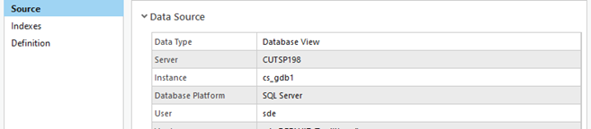

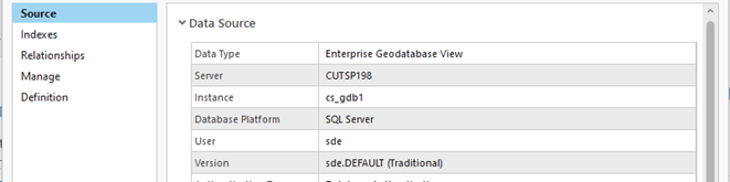

Esri Support mentioned in Case #03506437 that 3.2 does not display the Data Type of an unregistered view as "Enterprise Geodatabase Feature Class". Instead, it displays it correctly as "Database View" (or "Enterprise Geodatabase View" if registered).
Screenshots from Esri Support:
Registered:
Unregistered:
So that issue seems to have been resolved in modern versions of Pro. I will remove that part of the idea shortly, for clarity.
