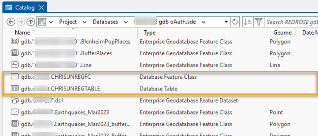

Hello Bud,
In ArcGIS Pro, you can already see the indication about unregistered items - in the Catalog view contents list, Type column, these items appear with different type strings, for example, instead of "Enterprise Geodatabase Feature Class", an unregistered feature class would show the type "Database Feature Class" (and a blank icon):
You can use this as the basis to sort items in the view, if you want to see them grouped together.
