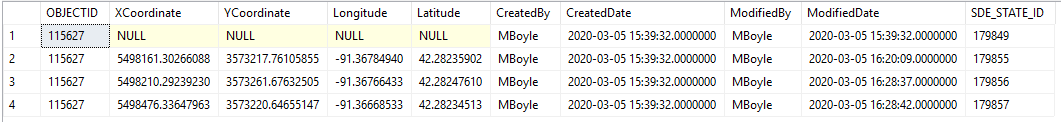

The trigger is on the add delta table of the feature class.  The screenshot below is a query of the add delta table showing the edit history of a feature (most recent last).  The trigger should update the XCoordinate, YCoordinate, Longitude, and Latitude fields after insert.  You can see that on the initial insert of the feature, those fields remain NULL.  Any edits after initial insert (rows 2-4) show those fields getting updated.

Hi,
I have come across this as well. ArcGIS seems to execute two db operations to create a spatial record:
  1. Create the geometry and OBJECTID.
  2. Update the record with the rest of the attribute values.
It looks like one operation to the front-end user, but in the background it is actually two. The solution is to put triggers for attribute values in an AFTER UPDATE trigger.
