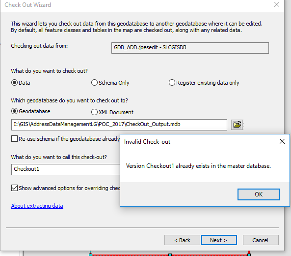

Sure-  Here's a screen shot when I try to reuse the name Checkout1.  It says the version associated with it still exists, but it gets deleted when you sync the check out with the reconcile and post option.

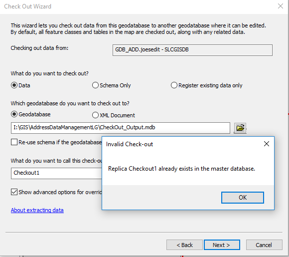

And here is the one that squawks about the Replica...

Take a look at the Versions table in the Database. Most probably you have that version there.

LeonS
I've run into that if I "Unregister" a replica in Catalog and then try to reuse that replica name in ArcMap prior to closing out Catalog.  If you haven't already, I would try closing out everything to ensure there is no connection to you geodatabase then try it again.
If that doesn't work there might be some orphaned records in your geodatabase.  You can check the GDB_ITEMS table to see if there are any references to the old replica, though I would probably go the Esri support route before touching anything in there!

Good catch Leon!  That did it.
asengupta-esristaff‌ - your comment below is spot on; I've been experimenting with a check out replica work flow and managed to write one to a wrong location, hence the version error.
