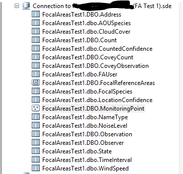

I copied and pasted a feature class from one enterprise geodatabase to another. In the catalog window, the naming scheme shows up correctly for the new database, but when I add the layer to the map, the naming scheme changes to the old database. New database is called FocalAreasTest1, old database is called FocalAreas. It only appears to affect the feature classes I copied over and not the tables. Any idea why this might be happening and how to fix it? The source looks correct, it's just the name in the TOC.
New database in catalog window naming scheme (FocalAreasTest1):

When you copy-pasted the features from one schema/database to another, it changes the Full Table Name, but the Alias Name remains unchanged. When you add the Feature Class/ Table to ArcMap, the LayerName shows the alias name, not the table name.
If you change the Alias Name in the Properties of the Feature Class in ArcCatalog, then the Layer Name will show as you desired.
